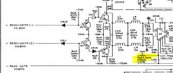

btw - I changed the value on the variable resistor R57 because I thought the gain is not good.
Shall I bring the position of the variable resistor to the same level as on my working drive?
After you get the pad in, yes, I'd adjust the level to the recommended spec.

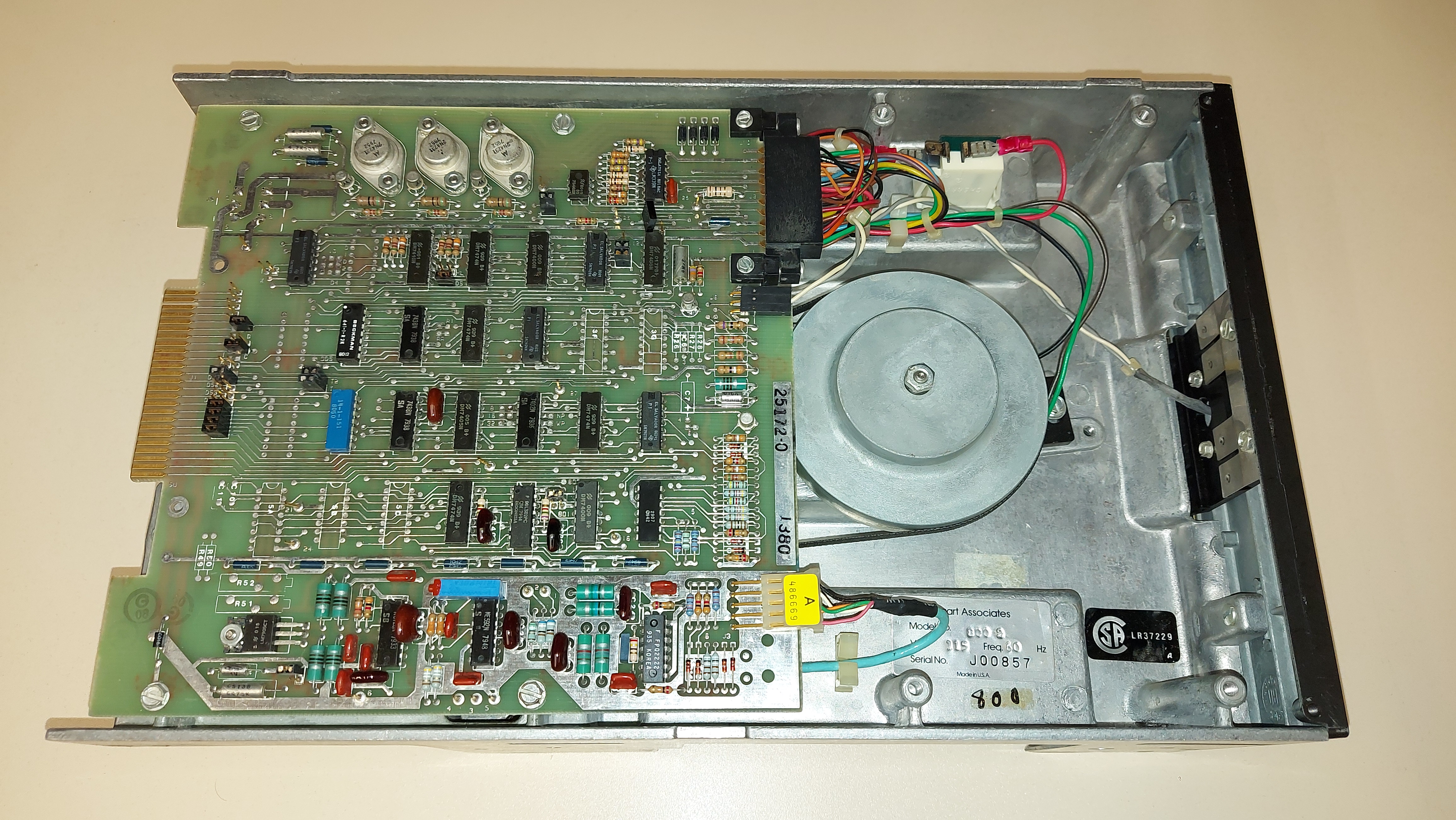

I have two drives: an 800-1 with a 25075-1 board and one 800-2 drive with a 25172-0 board. So I can't find any service manual with a schematic diagram of the 25075-1 board.
Drive 800-1 with a 25075-1 board
Drive 800-2 with a 25172-0 board
