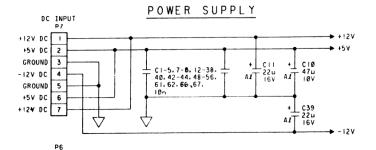

EDIT: I did find the bulk decoupling capacitors on the schematic:
C1 and C2 appear to be described as 10 nF.
I also had another look at the photograph of the burnt patch. Is it possible that the one lead that is surrounded by the burnt patch has shorted out against something?
It looks to me as though that lead of the capacitor is connected to the +5V rail (judging by the pinout of the interconnected ICs) - so I was just wondering whether this bent-over lead has accidentally shorted out to (say) the 0V rail?

104 is 100,000 pF = 100 nF.
What is on the schematic is 10 nF. This should be marked as 103 (10,000 pF = 10 nF).
Are you sure the glass capacitors are marked 104?
Anyway, the machine will quite happily run without capacitor C2 - or you can install that brown 104 potato!
