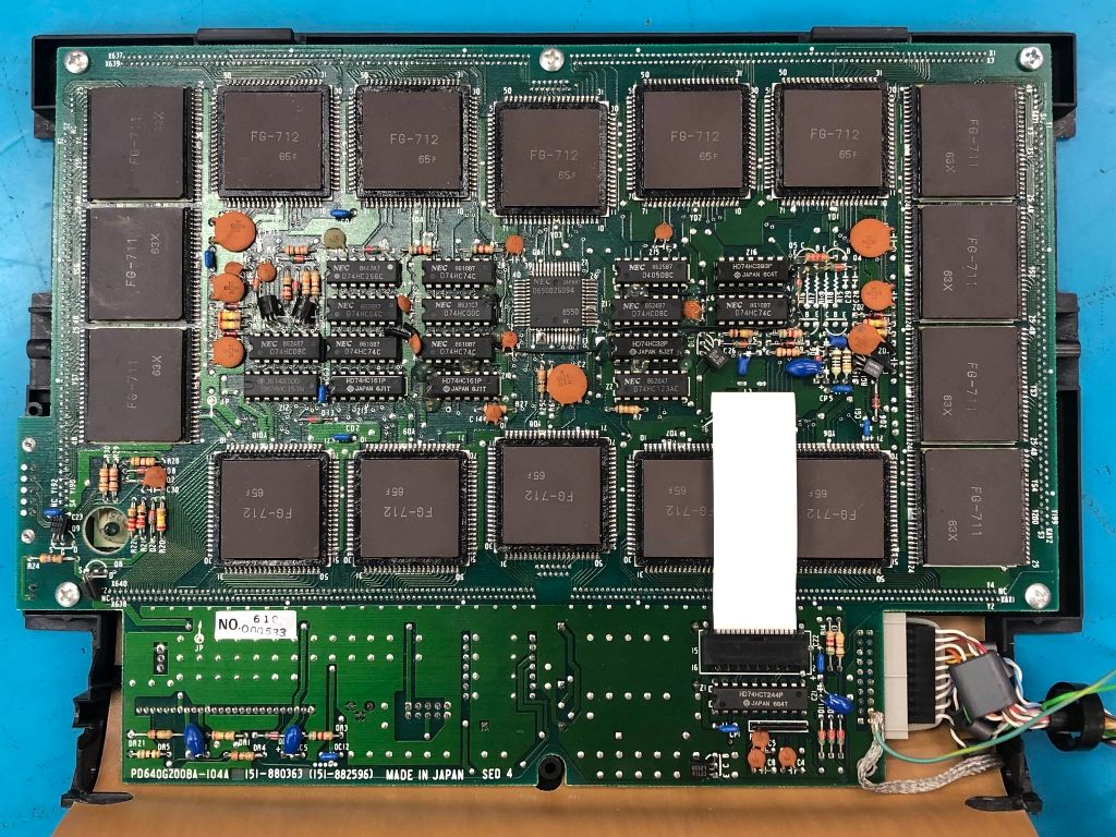

I took a pic of the display back.
The panel is PD640G200BA-104A and i believe it is made by NEC.
There are some similar panels PD640G200BA-BC panels on ebay for $600ish but that is very expensive and would probably require parts transplant. If the panel itself is bad we are looking at soldering like 2 thousand wires ;)

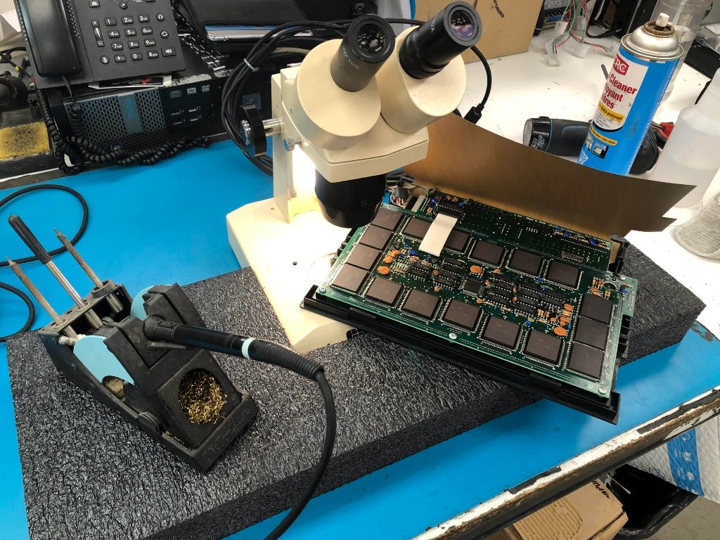

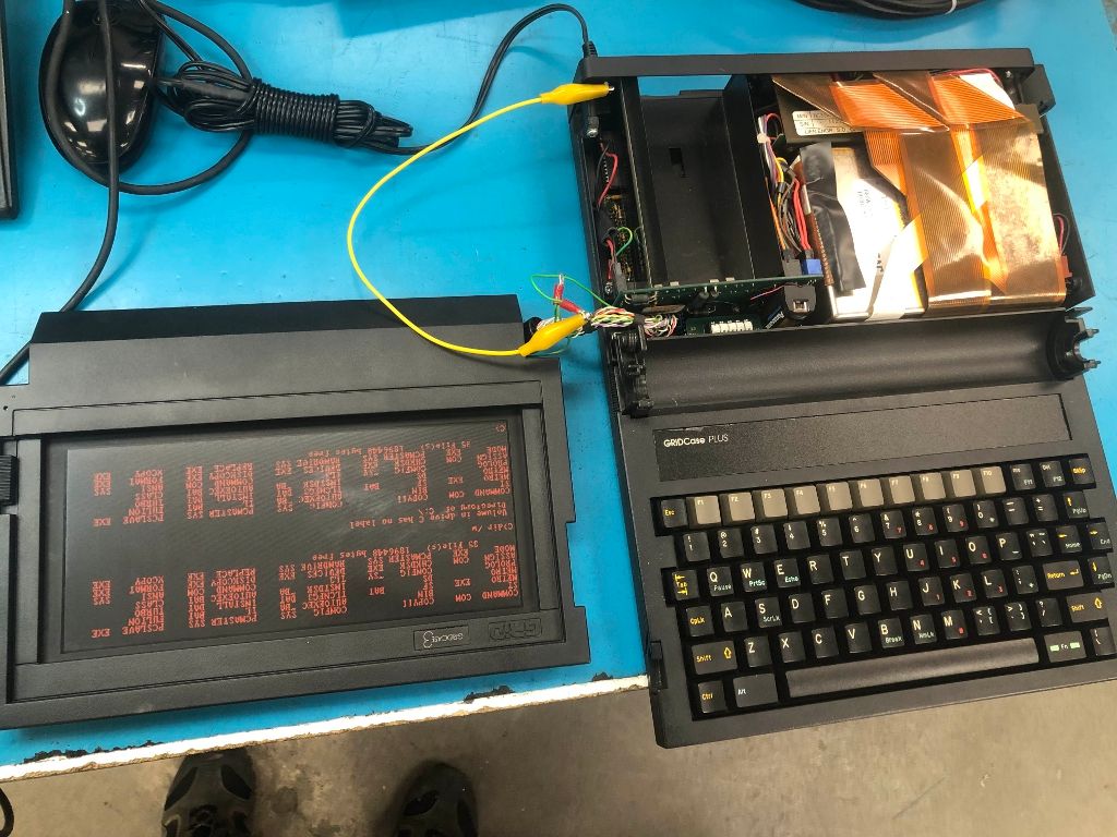

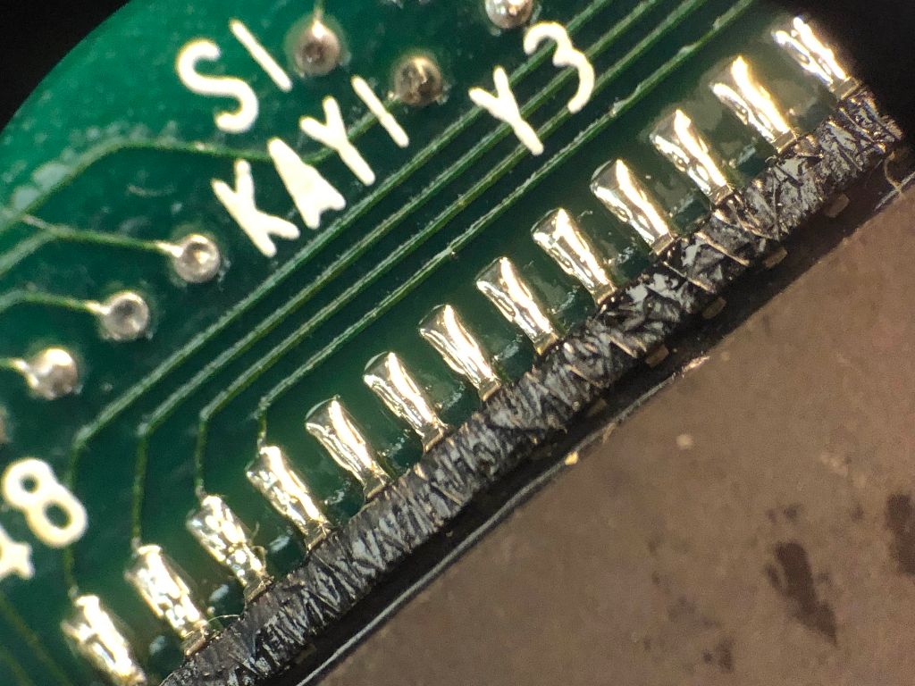

Finally had a chance to bring the system in and work on the screen in an ESD-free environment.

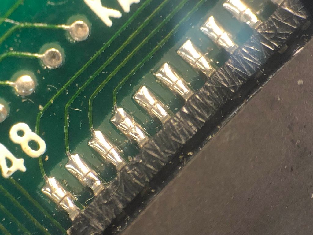

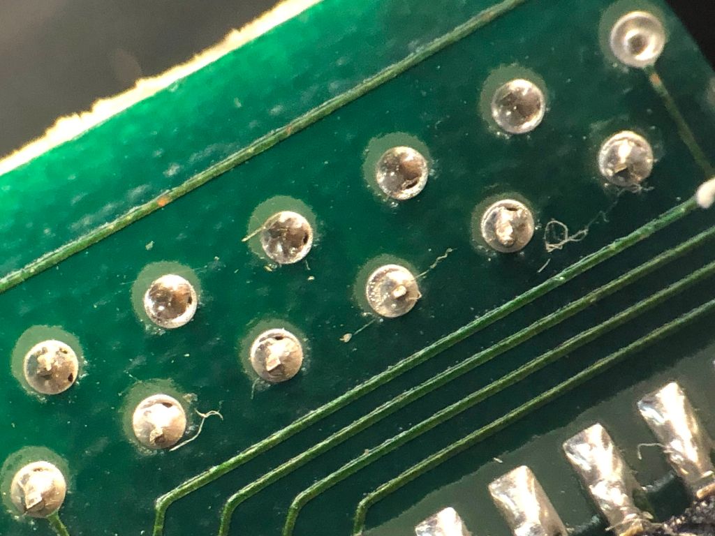

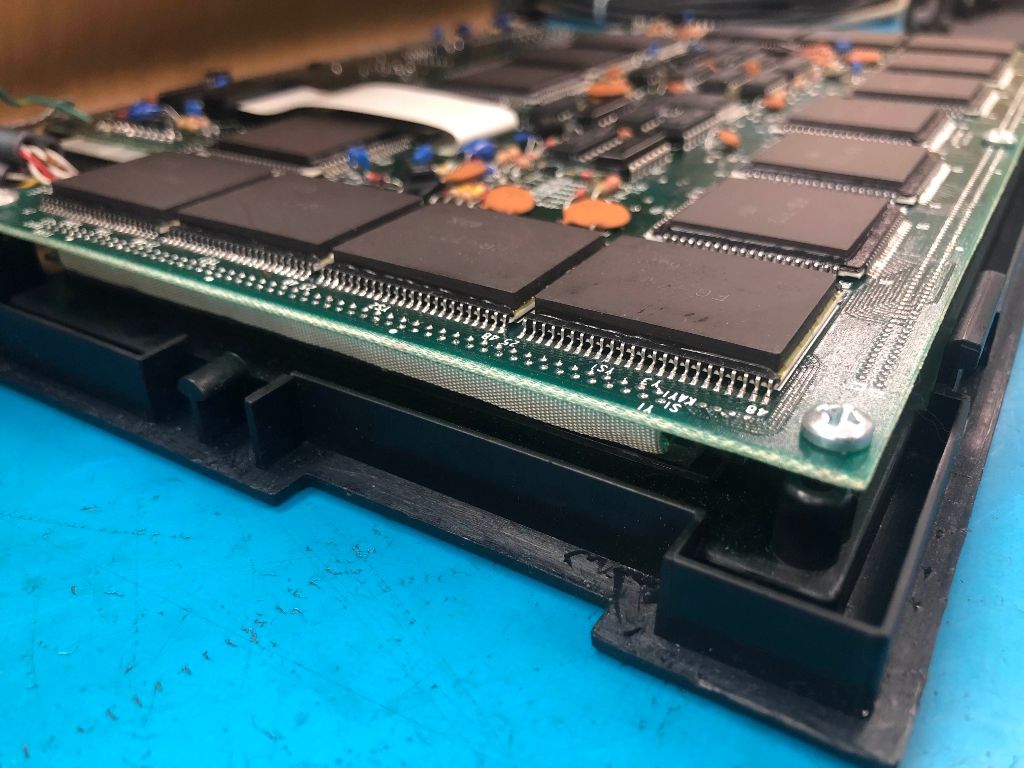

So the panel is indeed soldered to the board, however it has a wide cable attaching it, so pressing on the screen would of never located the bad connections in this case.
If you look closely in that photo at the closest Y sustain chip you might notice what isn't right. A number of the legs have developed cold joints and are just floating in the breeze. I'm almost willing to bet that this is our missing horizontal lines, but I forgot my AC adapter and will need to repair and test it tomorrow.
All right, this is interesting observation. If just reflowing it fixes stuff it would be awesome. I am more concerned about messed up vertical columns though.
Also, I think sometimes there is an issue with ever 2nd horizontal line caused by the cable from the motherboard.
Went under the iron today. To my surprise while inspecting the rest of the board I found a lot of places where both the wave and surface-mount soldering was not great. Many of the wires running to the panel have voids at their solder joints.
It's making me wonder how many other panels where I've seen missing rows or corrupt columns are because of soldering issues. Anyways, after carefully reflowing the pins I was happy to see all my horizontal lines came back and I now have a completely healthy plasma panel. :)
If true (soldering issues), hard to believe that (what I thought was) a high-quality product had such wide-spread manufacturing issues! While your (nice) equipment setup makes it easier, it's not like this isn't something that could be done to all those "bad" screens out there (although disassembly isn't that easy either).

I followed @NeXT footsteps and resoldered all driver chips on the back of two of my failing GRiDcase 3P screens. Both were cured. There is still little bit of weirdness showing up but the difference is incredible.
before
after
