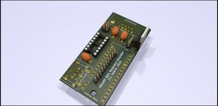

Anyway I think I can rotate the 7805 so its back faces the outside of the PCB, so a heatsink can be attached...
And here it is - with the regulator rotated and on the outside border of the PCB, so a heatsink can be attached.

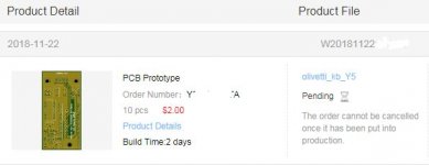

The PCBs have arrived!
... and here they are!
The PCBs have arrived, and I have quickly assembled one to test the layout, and it works!
I have tested it with my Chicony AT keyboard (~150 mA) with both the 5V supply and with the 12V supply regulated down to 5V, and it works in both cases. In the latter case the L7805CV I have installed (with no heatsink) heats up a bit but it's still only mildly warm to the touch (I'd say less than 50C). Anyway, a heatsink can be installed if need be.
A couple of minor notes -
- I had envisaged having the option to connect this directly to the keyboard port of the M24, without a cable. So I designed the PCB with the AT or PS/2 keyboard connector facing outwards (ie, if you are facing the front of the M24, right). However I had forgotten that the M24 motherboard is upside down, and hence so is the DB9 keyboard connector! As a consequence the PCB is also upside down if connected directly and the AT or PS/2 keyboard connector then faces inwards (ie left), ie towards the power supply fan housing. I think there is enough clearance to connect a PS/2 keyboard, but probably not an AT one - sorry. I think it's just more practical to connect the emulator to the M24 with a straight male-to-female DB9 cable like this $5 one and not worry about clearances at the back.
- The PCB holes for the mounting (not signal) pins of the AT (not PS/2) keyboard connector are misaligned - sorry about that. Not a big deal as the AT connector can still be soldered securely by bending the mounting pins inwards.
Here are some photos:
As you can see both the 74LS07 and the Arduino are socketed, and JP2/JP3 are not soldered in as they are not used yet by the firmware.
