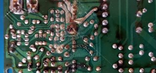

UPDATE: I was finally able to get around to examining this power supply further (after having just completed a repair on an Apple II system). What I found were a couple of electrolytic capacitors which have leaked (all the others look to be OK). In order to replace them I'll need to remove the PCB from the case of the power supply (which doesn't look difficult but it's not trivial either). Since I'll be in there I was thinking I should just replace all of the electrolytic capacitors instead of just the two. However doing so will require me to obtain each individual capacitor as I am not aware of any kit. This will take some time whereas just replacing two should be quick and easy.
Q: Should I replace all of the electrolytic capacitors? Or just the leaking ones?
After removing the PCB and examining the capacitors closely the answer became self evident: Replace all of them. I removed all of the electrolytic capacitors and several of them were or had started to leak. Testing each one with an ESR meter revealed that six of them failed. Here are pictures of a couple of the bad capacitors along with the underside of the power supply PCB board. I must say that I can see where Packard Bell earned its reputation as a low quality supplier given the amount of flux residue on the PCB.

I did clean the PCB with isopropyl alcohol to remove the electrolyte (and some of the flux residue, I can't believe how much flux residue there was on this from the factory). I also used flux and solder-wick to clean off the pad contact surfaces.
I order the new capacitors yesterday so hopefully this will be repaired in the next week.

I am replacing all of the caps with Nichicon. All of the ELNA caps leaked and are they are the six caps that failed on the ESR meter (no surprise since they leaked).
UPDATE: The new capacitors did the trick. Both the +5 volt and +12 volt rails are where they need to be. The hard disk now spins up (it did not before due to the low voltage on the +12 volt rail). There was a little speckling on the display (as if the VGA connector was loose or dirty) which has also cleared up (I assume this is due to better power on the +5 volt rail).
After seeing this power supply I am going to pull the 80486 systems power supply and recap it. All in all this recap cost ~$25 (it would have cost ~$15 but one of the resistors fell off and I had to pay ~$10 for one resistor).
