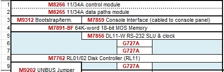

What set of modules have you? A basic installation with support for an RL01/RL02 disk drive would look like the attached, assuming that you use the M9202 to connect your DD11-CK. If not then you'll need a M9302 Unibus Terminator in the last slot.
Here is a list of my boards as found in the machine:
IDSlotFmtDescription
M726616CPU KD11-E (control module) Faulty (red paper tag attached)
M726526CPU KD11-E (data path module)
M82643411/34 No sack time-out
M7891-DB46256 KB MOS RAM with Parity Faulty (red paper tag attached)
5
G727364Bus Grant & Non-processor grant (PCB only)
M785674DL11-W RS232 Serial i/f & real-time clock
M781986DZ11-A 8-line double-buffered async EIA with modem control (50 to 96-Kbaud, 64-byte silo)
M785994Programmer’s console interface board
M931292Bootstrap/terminator with multiple ROMs. Damaged
M7258104Printer controller (Dataproducts interface)
M7800114Asynchronous transmitter/receiver (110-2400 baud)
None of these boards have been powered up or tested by myself up to now.
How to you reckon on 11 slots in a 9 slot unit?
If "Fmt" is supposed to be the number of tabs on a module ("height") then note that the G7273 is dual-height. And it goes into the C-D position. Be careful which slots and tab-positions you use for the different modules. Damage may otherwise result.
BTW, according to "MP00105_RK611_schem_Aug77.pdf" page 28-of-67 "Module Utilization" the first three slots are SPC so you are in a bit of luck :->. Read the Notes on that page for the caveats.
