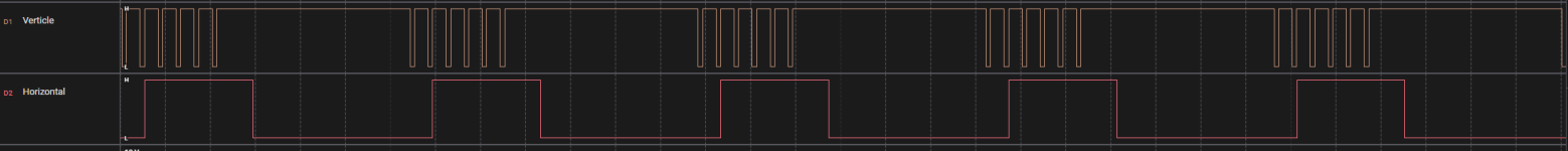

Vertical Drive Output on the PCB - Wayyyyy faster then 60Hz see "Video Signal.png"

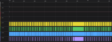

I then started going down the signal that generated the Vertical Drive output with a logic analyzer on each IC. Since its a repetitive signal I just watched the inputs/outputs and compared them to their logic tables to see if they were "good".
I can post scope captures if wanted but I determined that these signals were "Good"

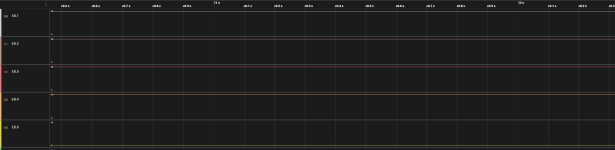

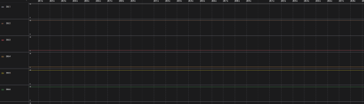

Looking at the latch with a scope instead of a logic analyzer it looks like all the inputs are stuck at like 1.65V which is below what it considers the minimum "High" of 2V.
Its voltage rails and clock signals look fine. None of its inputs look like they are <1M ohm resistance to ground while off.
