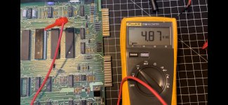

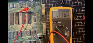

OK so I have done the measurements ----
As you mentioned its important to get the leads correct on each of the test points, so I have included images to show you what way I had the leads...
For C1, the voltage was + and not -.... based on the leads of the Multimeter being connected with the red/postive and black/negative on that Cap...
The others were all measured the same way using the same color code to + or - on the cap as labeled both on the board and the cap itself...
The readings were done with the MM set to DC...
C1 = +5.13 VDC (again this is based on the MM leads attached as shown on the board, when I reverse then, the meter reading is -5.13 VDC
C11 = +4.89 VDC (MM leads attached as red/positive and black/negative)
C7 = +11.95 VDC (MM leads attached as red/positive and black/negative)
So provided the C1 voltage is proper - then I will need to work my way down to see what the next issue would be...
When power is applied with the motherboard in this configuration (no monitor attached in anyway) - no chirp from the motherboard
(Note, the keyboard is not connected)
The schmatic you sent in the link is the one I have been working with (I too had to somewhat interperlate as the diagrams are various and numerious LOL)
So ........... ??? (just a side note, the only cleaing I have done to the board is from IPA and a soft brush to remove any grime and dirt from the past 40+ years, I have also pulled and re-seated each of the socketed IC's - they are installed with the "key notch" in the correct position - good to know I am not missing any IC's.... )
Thank you again for your help on this!

More boards eh!
Those DC voltages look fine also.
Excellent statement of how you are taking the measurements!
All positive voltage rails will have the negative ends of any polarised capacitor connected to 0V. All negative voltage rails will have the positive ends of any polarised capacitor connected to 0V. If you connect your multimeter positive to positive and negative to negative, you will always read +5V instead of -5V.
When I read DC voltages (using a digital multimeter that is) I connect the multimeter negative lead to 0V and take measurements with the multimeter positive lead. When measuring DC rail voltages the worst case is you measure the wrong side of the capacitor - and read nothing! If you trace the schematic from the output of the regulator to the pin of the capacitor you need to measure, the schematic will indicate which side of the capacitor is which so you can measure the correct side (be that + or -).

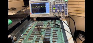

I also got my O-Scope yesterday.... its all configured and ready to go (image below) Hantek DSO5102P - nice and easy to use
As for the CPU tests, here is what I came up with :
Check the following signal with your multimeter (measuring the voltage between the 6502 CPU pin 40 (/RESET) and 0V/GND)
--------> With the multimeter attached, I show a low voltage for about a second or so, then a high voltage, this is confirmed with the Logic Probe - so OK on this part (volts in the image below)

6502 CPU pin 39 (PHI2) should be PULSING. This should be the clock output from the CPU - but will be at 1 MHz - so your logic probe may not be the right tool for this job.
-------> Yes you were right on this one, the Logic probe went wild... so I connected the O-scope to see what it was doing.... its PULSING at 1MHZ (or close to)

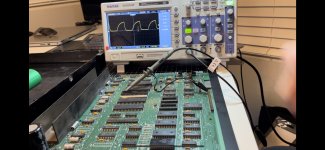

6502 CPU pin 7 (SYNC) should be PULSING - so I think this is pulsing, but the O-Scope was not so sure.... the Logic probe seem to indicate that pulsing was happening...
Screen shots attached: Explaination of each follows ---->
The file listed as "IMG_7855 3.jpeg" is the monitor connected to the 21V supply.... so at least I get a line across the screen - a good sign of life from the monitor
The file listed as "IMG_7860.jpeg" is the new fancy O-Scope with PIN 39 connected to show the PULSE at 1MHZ
The file listed as "IMG_7861 2.jpeg" is pin 7..... this one shows a lot of noise, and after I removed power from the computer, I had some left over artifact.... so its possible this is not doing what i expect, yet the logic probe seem to indicate it was pulsing....

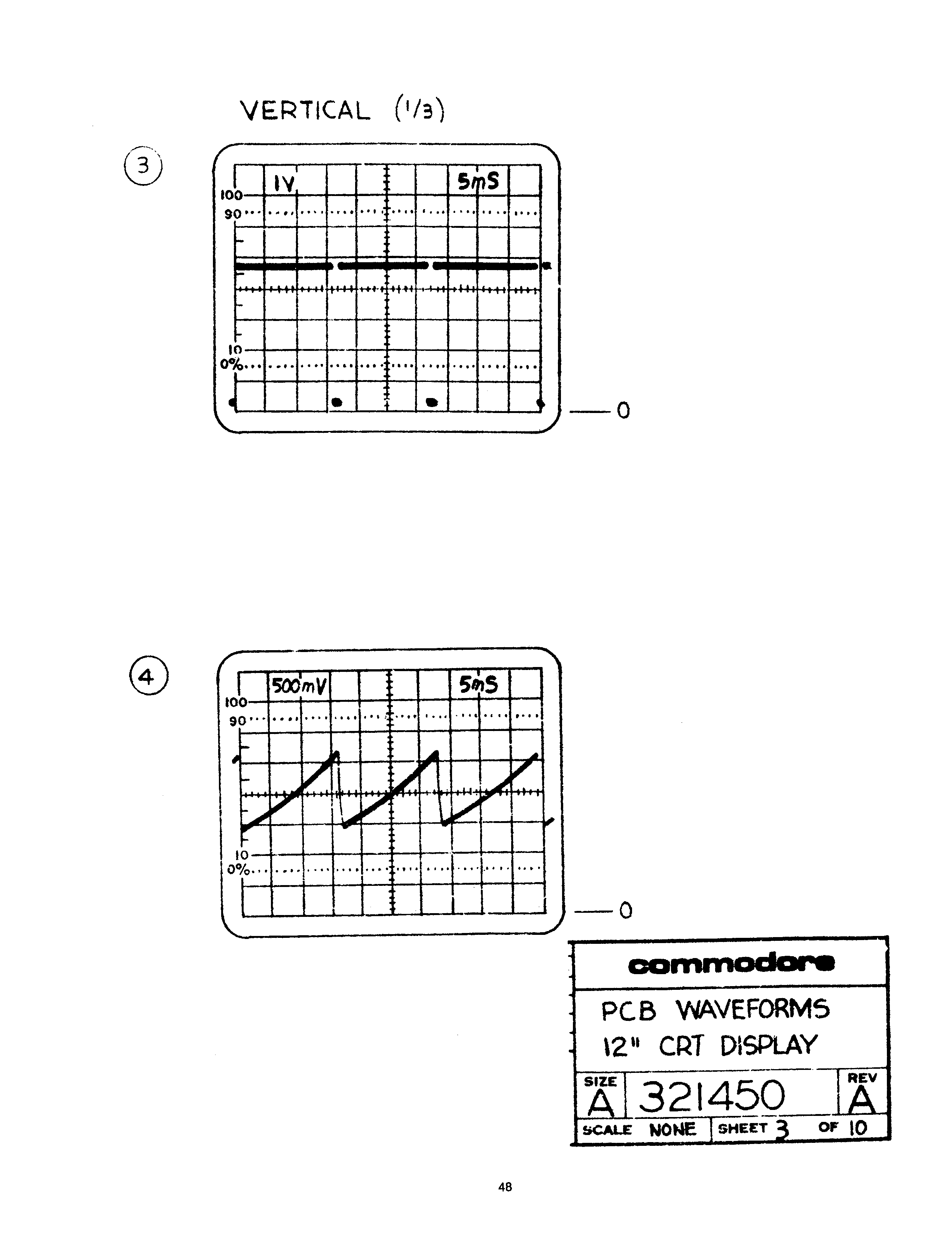

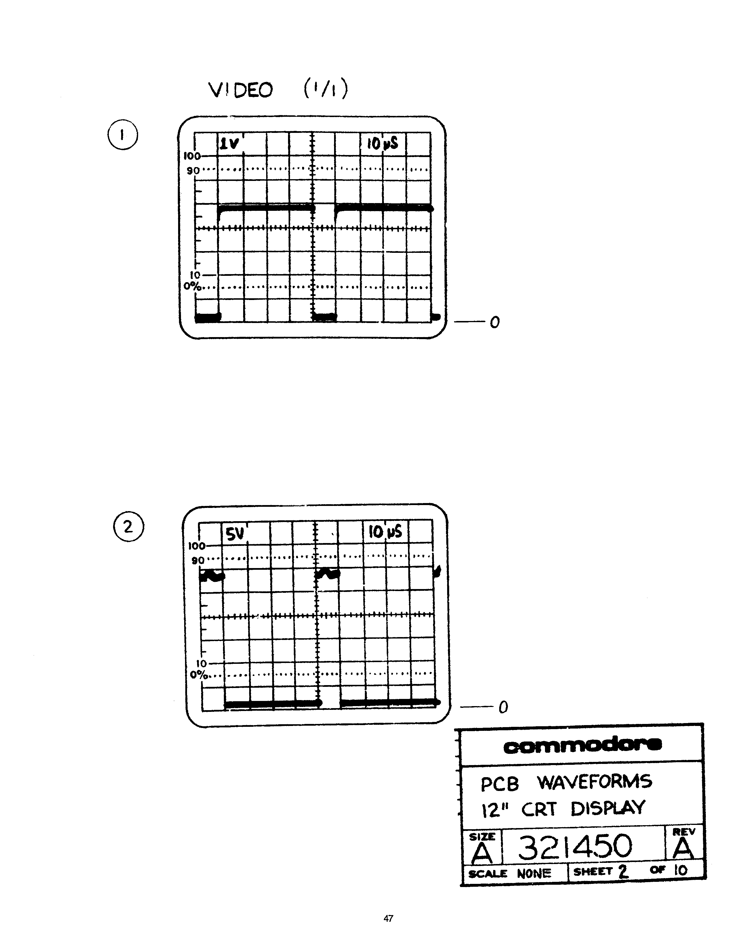

If we go back to a different PET, you can see the waveforms that we are expecting:
http://www.zimmers.net/anonftp/pub/cbm/schematics/computers/pet/8032/321450-02.gif waveform (1) is the VIDEO signal. Waveform (2) is the HORIZONTAL signal.
http://www.zimmers.net/anonftp/pub/cbm/schematics/computers/pet/8032/321450-03.gif waveform (3) is the VERTICAL signal.
All the traces have been taken at 1V/div and the timebase is indicated on the trace.
Note that some PET monitors had their signals inverted. Your PET board (being a universal board) has jumpers to invert the signals as required for the monitor. Therefore, don't worry if the signal is 'upside down' when you view it on your oscilloscope!
The video signal may not be as expected - but the HORIZONTAL and VERTICAL drive signals should be the correct voltage levels and frequency/period.
If the VERTICAL drive signal is missing on the PET, we need to work backwards in the logic to work out why. If the PET signal is there, the problem is in the monitor.

The /VIDEO signal is derived from UC2 pin 8 (7486 IC) : See Images IMG_7982 and IMG_7983... this would seem there is no video signal at the moment

VERTICAL DRIVE is derived from UC2 pin 6 : See Images IMG_7978 and IMG_7979... this also looks like a good VERT drive signal...
