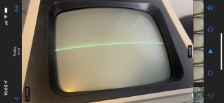

This is when I press the reset, it flashes for about .25 of a second....
This was with the non-edited pettest2kv4. I also ran the pettest2 file and it resulted in the "dot" in the center of the screen on a push of the reset button.... this "dot" got brighter and brighter then faded. The monitor no longer shows any signs of life.
Aka - flatlined. Lol

You need to 'divide and conquer'. You could have a fault on the PET main logic board or the monitor. Disconnect the monitor and 'scope the video and horizontal & vertical drive signals on the monitor connector of the PET logic board. The H and V drive signals need to be correct before you connect the monitor.

The video was the issue we were trying to trace. Since I last have the outputs from the last time it was suggested, the scope shows what I had posted a few posts back. So the video output is no good. I assume then we decided to try to run the PETTEST ROM in hopes it would init the video.... but it would seem that's not likely.
