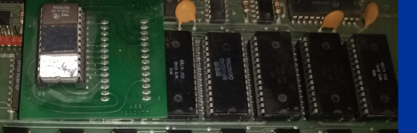

ROMS installed...
H7 EMPTY
H6 UVEPROM adapter installed upside down! Contains image slightly MODIFIED rom-1-d000.901439-02.bin and vanilla rom-1-d800.901439-06.bin. Should be in H2?
H5 MOS / MPS 6540 / 012 4278A -> OK
H4 MOS / MPS 6540 / 016 4278A -> OK
H3 MOS / MPS 6540 / 015 4378A -> OK
H2 MOS / MPS 6540 / 018 4478A -> OK but should be in H7????
H1 MOS / MPS 6540 / 019 4178A -> OK

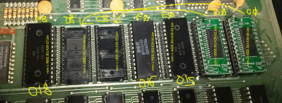

I created a ROM replacement which I named a "Omni ROMulator" which I now realise clashes with the partial name of the product you replied with! Great minds think alike. I will rename my device at the next rev.
Anyway
I replaced $C000-$CFFF with a 4K Omni at H1 (also replaces H5) images rom-2-c000.901439-09.bin & rom-1-c800.901439-05.bin
and
replaced $D000-$DFFF with a 4K Omni at H2 (also replaces H6) images rom-1-d000.901439-02.bin & rom-1-d800.901439-06.bin
I am using the original MOS / MPS 6540 / 015 4378A at H3
and
the original MOS / MPS 6540 / 016 4278A at H4

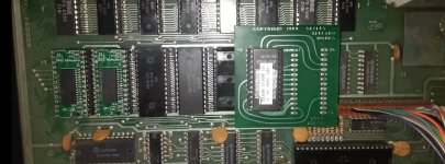

I then burnt the https://github.com/vossi1/2001test tester into a 2716 and put it in the Skyles's adapter at H7.
I also replaced some bad 6550 with parts supplied by Little Diode

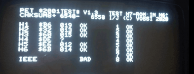

I get...

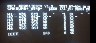

Running the tester..
Now the Skyles adapter is really designed for 4K so I think there is bus contention for $F000 and that's why the checksum of H4 is wrong.

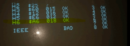

I also tested the original MOS / MPS 6540 / 018 4478A by putting it in H6 and get...
which I think proves that works and so my moving the MOS / MPS 6540 / 018 4478A into H7 and using the other ROM/Replacements tested above that should give me a complete set.
