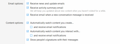

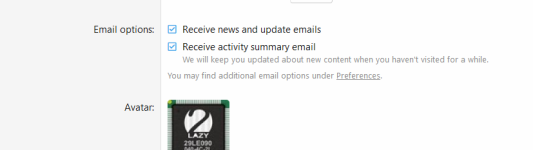

So @twolazy and I have sent a PM to and from each other, and both of us have received the alert emails without issue. The headers look good, there are no SPF or other SPAM protection issues going on at all.
So if you are not getting the alert emails please do the following:
1. Check you SPAM folder
2. Check any email filtering or rules you have, or check to see if there are any that you are not aware of.
3. Check that your email listed for you with us is correct
4. Check to make sure you have the correct alerting settings enable in your preferences here
5. If you have a custom domain that you receive email from, check to make sure your domain is not blacklisted for email or anything else (amazon/google may refuse to send email to domains they think are malicious).
Failing all of that, then let us know here. We'll probably need to handle these on a case by case basis and dig into logs on the back end to work out what is going on.
For now though, I think we'll have to consider this largely resolved.

Some feedback from me.
I ticked all of the email options in my profile a couple of weeks ago.
I am receiving DM/PM notifications (I always have done) but nothing else.
I am permanently logged on to the mobile site via my mobile (if this piece of information is relevant).
