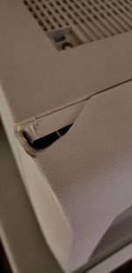

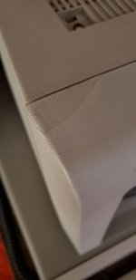

I have an IBM 5151 monitor and during shipping a piece of the front top corner broke. I got lucky and it is a clean break, so the piece fits in perfectly with little visual. However, while the edges are clean, I know I only get one shot at doing it right the first time. If not, the glue will make it next to impossible to reglue and have it sit flush. So I need to know what type of glue works best on the type of plastic used in that monitor case and what doesn't expand as it dries?
In gluing the plastic on similar cases like the 5153 monitor I found it was better to use high strength 24r epoxy resin such JB weld (called Araldite here, this version is clear).
While it is tempting to want to find a solvent that will re-bond the plastic with a molecular weld, in practice with old plastic it creates a very weak bond. Also as the solvent melts the edges, there can be some volume loss and the small mating crevices in the cracked edges are destroyed and this can hamper perfect alignment.
If the fractured edges are left as they are, being rough, it increases the surface area of the bond, so when the edges are approximated, there is only a very thin film of epoxy resin between them and the bond becomes very strong after it has cured. So my advice is avoid any glue that is chemically reactive towards the plastic and use 24hr epoxy two pack resin.
Also these IBM monitors do very well with a re-spray with Dupli-color spray, which chemically bonds to the surface an doesn't flake off and doesn't obscure the original texture either. I have talked about this very special paint on other threads.
But, now you have been given conflicting advice as whether to attempt to use a solvent or a glue, what to do ? Often it will be a learning experience if you have never done it, so if you wanted to try both methods, it would have to be the solvent first and the glue second, but as noted the effect of the solvent previously applied to the fractured edges will degrade the effectivity of glue, if attempted after that.

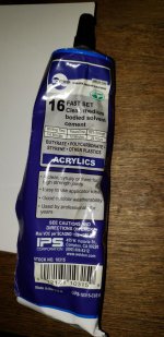

Okay, I found some solvent glue from a couple years ago when I had to fix a broken Lucite owl. Will this work, pic attached. Or how about the link to J-B clearweld. Will that one work?
Well, that glue says "medium bodied", which means that it does have dissolved plastics in it. Try a small bit in an inconspicuous place--it would be easier to handle that the pure solvent if it works.
Since I only have the one piece to glue back, how would I test it before gluing the piece? My guess is I'd have to try it on the same exact plastic as the broken piece, right?
