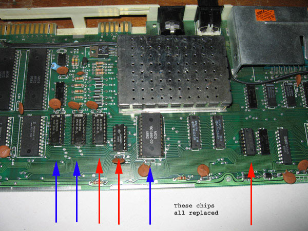

But then, is this even going too far? That same Vic 20 was repaired by me, and includes 6 chip replacements, with one of these chips being from a Terry Yager-supplied motherboard, which itself was an earlier Vic-20 version. I'm not even sure the motherboard presently in the Vic-20 came with the case in the first place.
Do I need to mention all of these things, to be totally honest to the buyer?
Can you see the point I'm making here? To the purist collectors out there, all these things might matter. But where do you draw the line? Most people don't even KNOW the history of their 2nd hand machines.
