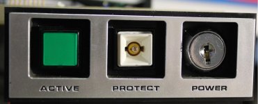

While working on the 16B , the "power on" red panel lamp bulb on the front has decided to call it a day, Can anyone point me to a supplier of these small bulbs,these are the same lamp bulbs as used in the 5, 12, 15, meg , trs 80 external HD units, used in the red, and green, square indicator lights, There are no markings on these bulbs,( just too small I quess) I have looked at digi- key, and tried to look at radio shack spare parts list for various hard ware, they do give there own part no. but no details? any help would be great. Thanks,

I don't know the answer yet, but here are some pictures for reference. The DIP is for scale, as I don't have any bananas handy.

I took some measurements of the lamp in my 15 meg disk system:
  • 5V present in the lamp socket
  • Lamp draws 112mA at 5V
  • Pin spacing is 0.1"
  • Pin length is 0.39"
  • Overall length is 0.807"
  • Insulator diameter is 0.192"
  • Lead diameter is 0.020"
  • Glass bulb diameter is 0.12"
  • Body length is 0.411"
  • Recess diameter in the socket is about 0.24"
I don't see any good matches on that Mouser page. All of the 0.1" spacing bulbs are 14V or 28V. The 7381 may be too large. The 7715 would work electrically, but I don't know if it would work mechanically by bending the leads.
It seems finding the 3/8" pin length will be the stumbling point! the Farnell lamps gslick has found looks favorite, and all the spec is done thanks to NF6X, I think I am going to have to get some and try, even if it means lengthening the pins. Great help, and response, many thanks.
