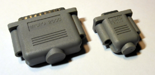

That does not look like a loopback plug to me.
That looks just like pass-though monitoring devices that I have: All lines from one connector go to the other (pass-though), with LED's monitoring the state of some of the lines.
A loopback plug only needs one connector - it is not passing signals/data to another device.
Professional serial loopback plugs looks like those shown in the photo below, which are the plugs supplied in a Micro 2000 diagnostic kit that I have.

I have used a Multi Meter to check my loop back plug:-
Shorted are 2-3 4-5 6-20 15-17
NB. The 2 25 Way ends are not used to pass through a signal they are to allow you to loop back on either a male or female 25 way connector.

Now that the photo is in focus, I see "LOOPBACK". I have never seen a loopback plug like that before.
That explains failure of the 'DTR to RI' and 'DTR to CD' loopback subtests in SERTEST, and loopback failure in CheckIt.
