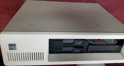

Hey guys, I have been interested in vintage computing for a while, but have just recently started acquiring some. I have an IBM 5150 that will be coming in the mail tomorrow (very excited!!!) that comes with a CGA card supposedly (I'm not sure which kind it is exactly, see pics in the link below.) Only the computer is coming, though, which has left me a lot of time to think about which monitor I want to get. On the one hand, the 5151 is classic, has the true vintage look and feel, and I've always wanted to get a green phosphorus monitor. On the other hand, it would be quite limited, and I will be wanting to game a bit here and there on it.

I don't see anything that indicates it has a CGA card? It looks like MDA or Hercules.
There are also quite a few options for displaying CGA/EGA graphics on an IBM 5151 or equivalent mono monitor. Most famously the early ATI Wonder series, but there are others - they could either coexist with a Hercules/MDA or support these modes natively as well.
I'm thinking it's Hercules. I have asked the seller and they said it was "CGA/MDA" which is Hercules, no?
