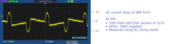

The photo does not show the output rating. It shows an input rating of "INPUT: 110V, 3A". One has to be careful with those. It is easy to think, 110V x 3A = 330W, and therefore this PSU is capable of supplying about 300W. The 3A is likely to be a peak amperage figure for what the PSU consumes, not directly related to the sustained power that the PSU can deliver.
My IBM 5153 is an example of the name-plated current figure being an approximate peak input figure.
I measured the average AC current consumption of my "100-250V~@0.95A" marked IBM 5153.
245 Vac
My 5153002 with video input (a few lines of text) = 0.43 A
My 5153002 without video input (white screen) = 0.48 A
120 Vac
My 5153002 with video input (a few lines of text) = 0.55 A
My 5153002 without video input (white screen) = 0.64 A
The average current consumption is about half of the "0.95A".
What is actually going on is shown below.

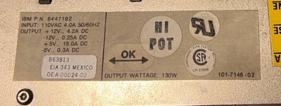

Looks like that Astec supply is dated 1983. I’ve got a loose IBM supply from 1986, that must be a different manufacturer. It lists power ratings almost identical to what is on minuszerodegrees. The only difference I see is that one of the voltages is shown as .25amps instead of .3 amps. Also it seems to list the amp limit of the individual conductors on the power connectors:
