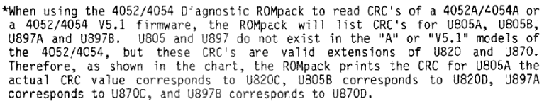

Jos posted a TEK_Supplied_CRC_Lists.pdf dated July 22, 1983 with his 4052 Diagnostic ROM Pack files.
On page B-2 there is a note about using the Diagnostic ROM Pack to read CRCs of 4052A/4054A or 4052/4054 with v5.1 firmware.
This note puzzled me until now, and my 4052 CRC dump program using the Diagnostic ROM Pack CALL "CRC" shows CRC values for U820A,B,C,D and U870A,B,C,D which match the V5.1 firmware versions in that same document.
In order to get my program to match the Tek document I had to change the memory range for several of the ROMs.
I think you will need to adjust the ROMs in your emulator as I believe you are using 4052 v5.1 ROM images.
In my latest 4052 CRC program (today), I have changed the comments to include the ROM range for the A,B,C,D subdivisions of U820 and U870 as shown in my photo:
Note that the memory address ranges for U820 segments are NOT contiguous and different sizes!
U820A is larger than the U820C and U820D ranges and U820B is the largest segment.
This change in v1.5 ROM decoding may be keeping your 4052 emulator from working.
And I also discovered in this exercise that the 4052A/4054A MAS boards have an additional EVEN/ODD pair of ROMs decoded in the 0-3FFF Bankswitch area!
Apparently the Diagnostic ROM was not changed to add CRC tests for those 'new' ROMs.
I added both of them (U845 and U863) to my CRC test program - if the program detects the computer is a 4052A or 4054A and here is my 4054A test output including those ROMs:
I kept the same address ranges for my CRC tests as on the 4052 - although that may not be correct as the A-Series decode for the ROM space is a single decoder with four outputs. The CONSTANT ROM decoder is different as it is decoded on the high end of RAM address range.
