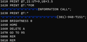

You mentioned having junk characters.
I just uploaded a new file 1 and new zip.
the "junk" in the original pgm lines 1620 and 1630 were CR characters at the beginning of the print string.
I replaced those with CTRL-underscore (US character for new line).

I captured a trace of the BAPPEN call in operation on my 4051. The function does send an EOI with the last character and the trace does confirm that.
One thought that occurs to me is to leave out the final FF. This is easy enough to do. Just located lines 527 and 528 in AR488_Store_Tek_4924.cpp which look like this:
err = gpibBus.writeByte(c, DATA_CONTINUE); err = gpibBus.writeByte(0xFF, DATA_COMPLETE);
Comment out line 528 and change line 527 to look like this:
err = gpibBus.writeByte(c, DATA_COMPLETE); // err = gpibBus.writeByte(0xFF, DATA_COMPLETE);
This does work on the 4051, but generates an error:
MAG TAPE ERROR IN IMMEDIATE LINE - MESSAGE NUMBER 55
I believe this is the same error that was reported on the 4054 with the current code? However, the file does get appended and the program can be run. Re-instating the original lines gets rid of the error.
I would be interested to know whether the above mod has any effect on the 4052 or 4054? Does it perhaps not like the FF on the end of the transmission?
Page B-2 of the Binary Program Loader's Operator's Manual gives the meaning of error message number 55. The first item about the tape head can be dismissed although if the file pointer is not at the begging of the file for some reason (e.g. a FIND is required) then this is going to produce the same result. The remainder focuses on the wrong type of file being used (ASCII vs BINARY). This suggests that the routine does somehow differentiates between ASCII and BINARY files. I did wonder whether those apparently superfluous bits at the end of the binary files (essentially repetitions of file headers and spaces) in the original Opt30Demo directory might be having an effect. I edited one of them in a hex editor to remove that section and tried loading the before and after version using BOLD on the 4051. Both versions completed loading without the 4051 complaining which tells me nothing really. Obviously I could not run or do anything with the result on my 4051, but a LIST did not produce a coherent listing. The screen displayed fragments of program code, gaps and random characters and finally rebooted showing the Maxirom startup message.
Monty I then tried you modified demo for the 4051 with option 5 as suggested and this produced a menu and the pacific coastline (see pics).
