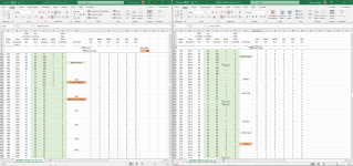

Here is the decoded logic analyzer trace for BOLD.
I think row 1279 to the end matches the BOLD picture.
I see controller issuing a CLOSE followed by the 4924 issuing an EOI and then controller issuing UNTALK and UNLISTEN and thats the end of the trace. I had to stop the capture so I know there was no more transitions on GPIB.
There is a weird 36 decimal issued by the controller before the CLOSE.
The picture of the end of the BAPPEN trace closely matches the BOLD picture.
Thank you for the detailed trace of the 4924 operation. I see the CLOSE command after the binary program read operation is completed. I notice that there is no EOI at the end of the data being sent? The EOI only comes after CLOSE.
The 36 decimal is hex 24 which is LISTEN 4 which would make sense for the CLOSE command. Prior to this we see UNLISTEN and UNTALK, so the controller has to address the 4924 to listen again.
Looking at the format of the binary program files, I see that each one starts with 40FD, then there are a couple of null bytes and then a series of bytes before a 20 (space) and then the file description starts. I wonder whether that sequence of bytes includes some kind of checksum so the Tek would know how much data to expect and therefore does not need an EOI to terminate the transmission?
I did a quick experiment and removed the EOI but this also failed, so there is more to it I suspect.
I don't have much time today, but will have another look at this later on.
I checked the Tek_4924.cpp file for EOI - it looks like we only have code that sends EOI, where the BAPPEN shows the controller is sending the EOI after the CLOSE command to the 4924?

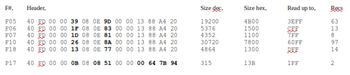

I have been experimenting with these binary files in the emulator to see how they behave. In there I can enable some logging and see exactly the bytes that are being read. I have noticed something rather interesting. With the Opt30 Demo files, each time one of the binary files is read, it is only read up to a specific point. The complete file is not read. You can probably guess where it stops - at the point where the superfluous lines start.
Remembering that these files were originally on tape, to occurred to me that maybe the file is being read in exact 256-byte records, and that appears to be the case. I checked 5 not quite so random random files (coastline and helicopter were already on my radar) and each time the read stopped on a 256-byte boundary. I made a table including the file number, the first 14 bytes (up to the space and file name), the size of the file, the size of the file in hex, the point the file was read up to and the number of records that were read.
One thing to note is that since the Tek always stops reading at a specific point despite the file on disk actually being much longer, means that somehow the Tek can determine when to stop reading. There is no specific byte or byte sequence at the point where it stops reading. It just happens to be at the exact end of the file data and on a 256-byte boundary. The additional superfluous information is just ignored. My guess is that the entire file represents the number of records originally allocated (marked) for the file on the tape, versus the stopping point which represents the end of the last record that is actually used.
Secondly, an FF byte is NOT sent at the end of the transmission.
When you look at the table it becomes apparent, at least for the Option 30 demo files, that only two bytes in the header actually change, but I can't see a pattern.
Then there is the last line, which is a file created on the 4051 and saved as a binary file to the flash drive. What happens with this one in the JavaScript emulator is interesting and weird. The file is 315 bytes long on disk, however, the emulated Tek will continue to "read" this up to hex byte 1FF, i.e. exactly 512 bytes, filling the remainder with null bytes. The reason this is even possible is down to a fluke in the JavaScript emulator code, however, it does demonstrate that the Tek is trying to read in blocks of 256 bytes as would have originally the case when using tape. Since my disk file is only 315 bytes long, which is more than one 256-byte record, the Tek wants to read 2 records, or 512 bytes. The opening sequence of bytes for this file is somewhat different to the others, although up to the 10th byte, perhaps not that different.
What does all of this mean? I don't yet have a full understanding, but when BOLD or BAPPEN is called, the flash drive will try to send the entire file. When it reaches the point that the Tek wants to stop, the flash drive will remain in talk mode and want to keep on going which may explain the hang.
Quite how the real 4051 manages it, I don't know, although the FF+EOI being sent at the end, despite apparently being incorrect, seems to be enough to terminate the transmission and make it work. Perhaps the 4052 and 4054 have stricter handling and expect the correct number of 256-byte records?
Could it be that transmission needs to be interrupted by the Tek by sending an ATN? We already seem to have that capability implemented in the code and certainly on the first 4924 trace that I was sent, there is an ATN and then UNT+UNL so transmission ought to have been stopped at this point. This case is a little different to ASCII files where we are looking to pause the transmission. Here we are looking to end it. However, even if we could interrupt, that technique is not going to work for disk files because they are very unlikely to finish on the exact 256-byte boundary. For example, for the 315-byte file mentioned above, the flash drive will send exactly 315 bytes. The Tek will sense that transmission has stopped prematurely and display a MAG TAPE ERROR (which is what does actually happen without the FF+EOI). Satisfying the Tek would require sending "padding bytes" up to the 512-byte boundary. In order to do so, the flash drive would need to be able to calculate this. (Alternatively perhaps BSAVE would have to create files on disk that are exact multiples of 256 bytes, padding up to the last 256-byte boundary?) On the other hand, as can be seen from the Opt30 Demo files, where files are longer than the total number of used records, there needs to be a means to stop after X records has been read. So the problem is actually two fold: sending in 256-byte blocks and to stop sending. The latter means either determining X or allowing interruption. Does the 4924 firmware read the header bytes and calculate exactly how many records to send? Or does the Tek interrupt it?
Plenty of food for thought.

The trick now is to replicate this on the flash drive..... and then hope it works on the 4052 and 4054 as well.....
Ok, I believe I have replicated the process I got to work with the JavaScript emulator on the Flash Drive. I have uploaded an update to the repository. It loads both my test file and a couple of the Option30 Demo files I tested (coastline and helicopter)) without error - at least on the 4051. I don't know at this point whether this solves it for Option30 Demo files on the 4052 or 4054, but I am hoping that it will, at least, work for files saved using BSAVE on the flash drive.
Your latest code didn't help, but my logic analyzer captures of the 4924 BSAVE and BOLD have the answer (I hope) :)
  1. Internal and 4924 tape files are in data blocks of 256 bytes (file header is in special 'hidden' block of 256 bytes)
  2. When a tape file is created - based on number of blocks requested, all data blocks are filled with spaces
  3. When a 4924 receives a CLOSE during a SAVE or BSAVE - the 4924 writes FF after the last character.
  4. When a 4924 is sending a BOLD (and possibly OLD?) file to the 4050 it sends whole 256 byte blocks.
  5. The 4050 buffers the 256 byte blocks and if it finds an FF it sends a CLOSE to terminate the BOLD transfer
zip file attached with Excel files, pdfs of excel and this side-by-side screenshot showing the FF being sent in BOLD but NOT in the BSAVE data!
