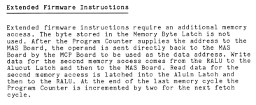

The 4052 technical manual states:
This (I take to mean) for any extended instruction that a 2-byte pointer follows the instruction opcode. The data found at that memory location is then used as a 16-bit pointer that points to the instruction operand itself.
However, many other (none 4052 instructions) use EXTENDED mode to reference their operands.

Dave,
I think Tektronix called ALL the "NEW" 4052/4054 and 4052A/4054A opcodes Extended - see this page in the 4052A Assembler doc:
Therefore - this has NOTHING to do with the opcode addressing mode - which is exactly the same as the 6800 - including the A-Series opcodes that require a C7 or FC prefix byte.
The Assembler document lists the processor opcode addressing modes for each of the new opcodes - same as a 6800:

Since the 4052/4054 have A and B 64KB address spaces - each of which can have executable code in one space and data in the other space, that does blur the 6800 addressing modes descriptions above since the word "memory" in the 6800 is anywhere in the 64KB memory space (RAM and or ROM).
IMM mode for 4052/4054 is clearly describing the operands follow the instruction in the same SPACE as the instruction.
DIR mode on the other hand appears to always require access to the RAM space A for the reads and writes. And the default CC bits Fetch from B and Data in A
EXT parameters are an executable address - so must come from the FETCH space - which could change if the Fetch CC bit previously changed.
I think your microcode emulator needs to exactly match the 2901's and hardware on the boards :)
That is what I am assuming. That the EXT addressing mode in the 4052 and 6800 instructions are the same.
However, the JMPIN instruction ($38) does not follow this rule. So there is something else going on within the MCP logic somewhere to differentiate the two different cases.

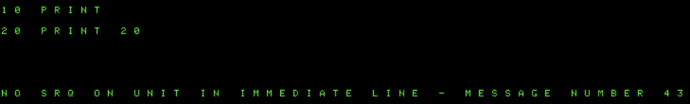

I managed to enter a (very simple) program and list it!
I even tried to run it... but the message about the SRQ is quite insistent...
I haven't fully investigated (or implemented) what I have found out about the JMPIN addressing mode, but I fear there are still some 'gotchas' in there to address...
Still, moving in the right direction!

How does your 4052 Emulator handle the GPIB? Same as the 4051 Emulator?
Interesting that the LIST is somehow also checking GPIB - but I think this is expected behavior as the LIST command supports GPIB devices if you add @d to the command or use PRINT @d,19: where the 19 is the secondary address for the LIST command.

There is a difference between the documentation saying that the 4052 has an 8-bit A and B accumulator (because the instruction set only uses the A and B accumulators as 8-bit registers) and the accumulators physically being 8-bits.
The registers are stored within the four off AM2901A devices. Each device containing 16 * 4 bits of RAM - the RAM being used as registers.
By default, therefore, the A and B accumulators (which occupy two (2) of the RAM/REGISTER words) are physically 16-bits wide.
I suspect the microcoded MACRO instructions only treat these two accumulators as 8-bits.
I would be interested in seeing where the high bit(s) get set from through... It is possibly the microcode self-test routines?
My error was accidentally using all 16-bits of the accumulators when I should have used only the lower 8-bits. If the power-on self-tests accidentally leaves some bits set in the high byte of the A or B accumulators, then the resulting hardware (and hence my emulation) should have masked these higher bits out. It does now!
I am still hunting through the ROM code to find out where the subroutine is called to set-up the appropriate interrupt table in RAM.
Plenty of false leads...
From the Technical manual I believe the 4052 high bits of register A and B are set in MCP "ZERO HIGH/SIGN EXTENDED" hardware during the data transfer to the ALU A or B register.
