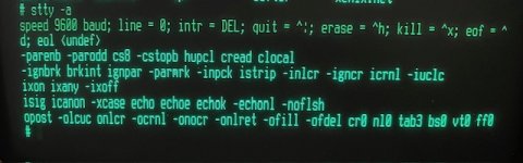

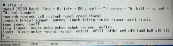

So this is what I've done.. I have tried various scenarios.. Going back to the begining.
#1. The first photo is stty -a from the terminal which is assigned in pconfig as an "altos3".
#2. The second photo show's the stty -a which is setup on a remote connection on a laptop via IP as a vt100 in pconfig.

Perhaps I am not doing something right. I just have a feeling it is pulling termcaps that are assigned to that port I am connected to and not based on the user's stty settings.
Now if I go in a word processing program which is Uniplex the backspace and arrow keys all work just perfectly fine in both scenarios. And the only reason I use Hyperterminal and not Putty or something else is because it get's me as close as possible with the vt100 emulation to looking exactly what a terminal would look like. It draws the lines around the menu system perfectly like the terminal. I have tried a whole bunch of terminal programs and they stink.. Hyperterminal comes the closest. I have tried all different terminal types such as Wyse, and Televideo's and nothing worked well enough.
So if backspace works fine in the application I pull up which is Uniplex.. then it has to be a termcap issue with the termcap file for the Mail program I am using. For kicks I set the port to Altos III and the backspace works just fine. The problem is that it doesn't draw the menu system properly as it should. So really I think this is a termcap thing. I think that it pulls the terminal settings (termcap file) from the folder where the program resides. The mail program has it's own termcap. I will attach it here too. There has to be a modification in the very bottom I believe for the VT100 terminal cap file..

So it was the termcap file in the mail program!!!!! I simply copied the Altos III terminal caps entries to the VT100 entry area and works like a charm now!!!!
This is such an old version of Xenix.. It is a custom Xenix 3.0 for Altos machines.. so it's really old. Doesn't have all the new fangled things like today. And it's qwerky how they did stuff then and I guess they may have had termcap files for each program.... that's what it appears like!
