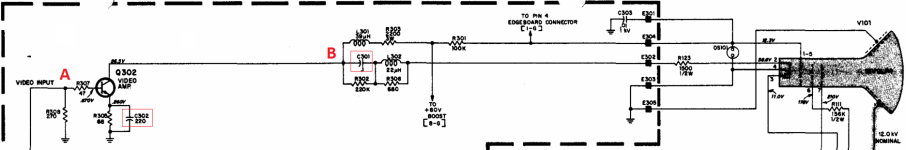

Hunting through the VDU schematic sent by Idkraemer, the video output stage in this set is super simple (see attached).
Check with the scope on points A & B, that there are sharp edged rectangular signals, and check that the resistor at C has the correct value and check the emitter bypass capacitor at location D. AS a start, if we cannot see the issue here we will have to look at the circuitry feeding the contrast control, but if that is digital the fault wont be there.
It is also worth scoping the CRT's cathode (x10 probe), just on the off chance (it is fairly rare) that the CRT has developed heater to cathode leakage and is corrupting the frequency response that way, but it does not happen very often.

The internal mail system bounced for some reason, With regard to C301 in the circuit fragment you attached:
If C301, a signal coupling capacitor, if it was defective, open or high ESR, it would just leave the 220k in circuit to pass signal , that in conjunction with the CRT's capacitance would create a low pass filter, causing the smear and loss of high frequency detail in the picture.
The circuit is drawn like it is a polarized electrolytic capacitor. If it was a film type it would highly unlikely have failed.
So I'm not certain that it has failed, or if it is actually an electro or film type, but it is worth checking. I would probably replace it with a film cap of the same uF and voltage rating, or a higher voltage rating if that was what I could get.
I'm still not certain which is the exact schematic for your set. But the basic plan would be to trace the video, with the scope , from its output from the computer, all the way through to the CRT cathode. It should be pretty easy to find where the high frequency response gets degraded.
@jlang @Hugo Holden Update on this. I have the RCA video board in my Model II. I've replaced C301 & C302, no change. Put a scope on either side of the video amp points A & B, see below. The input doesn't look rectangular. Has me wondering if the problem lies on the video card?
Yes, the video on point A is very abnormal and the signal looks like it has been integrated and it is consistent with the mess on the screen.
The video signal needs to be traced back to its source on the video card.

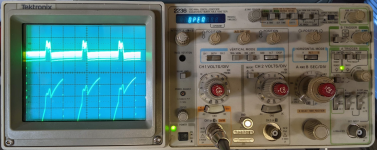

Here are the updated scope shots:
CCLK
VSYNC
HSYNC

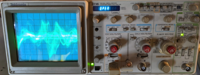

Video Signal Before Amplification (Point "A")
Video Signal After Amplification (Point "B") - The bottom trace is the cursor flashing on & off
Close up of Point B #1
Close up of Point B #2
Flashing Cursor:

Can you measure the frequency or period of those pulses seen on point B ? they might just represent coupled H rate pulses rather than graphics signals and the gain of the scope turned up too high for the voltage there, generally the modulation at the CRT cathode would be in the 30 to 40V peak to peak vicinity...so set the scope& probe combination to maybe 10V per cm and use AC coupling for that measurement.
If that other wave that was recorded was part of the graphics/cursor signal, it is abnormal with a inverted exponential profile, but the scope input might be over-driven.
Make sure to fill the whole CRT screen with graphic/characters of some sort , so there is plenty of video signal to see on the scope trace. And report the scope's vertical voltage scale per/cm and the timebase per/cm settings.

The period of the signal (at Point B) looks to be 150 microseconds or 6.6 Hz frequency. Amplitude is reading about 4V.
Point A
Volts / Div: 2
Sec / Div: 50 microseconds
I switched to the x10 probe and set Volts/Div to 10, here's what Point B looks like with .5 msec per Div:
Yes the signal is a mess corresponding to what you see on the CRT screen.
Stay with the x10 probe. Set the scope to something like 5V/div and test the signal at the Base of the video output transistor again (point A on post #10). You could speed up the timebase to maybe 0.1mS/div to spread the pluses apart more.
The signal input to the video amplifier transistor base circuit looks very abnormal and even worse than what is on the collector circuit and it is not a proper digital drive voltage corresponding to the text. The VDU may well be ok and it is just receiving a corrupted signal.

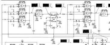

I suggest following this signal back into the computer & video card.

Agree about tracing the signal back. I've already started that process. I'll report back when I have some more info. Thanks!
