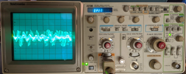

The grounding looks ok, probably if its all manufacturer done, but you can still check with the scope. I had not seen inside one of these units before.
When you are testing it, the video signal at the video card end, also put the scope on the +5V rail that supplies the IC's in that area on the card and check that for noise. I'm wondering if the output from the SMPS is not clean as the signal you measured on the scope looks like RF interference, with components of it, in the 2MHz vicinity, which is unusual if the power supply was clean.
If you put the scope on AC coupling, you can check for ripple on the power supply outputs.

@Hugo Holden I deleted a bunch of the traces above because they were (as you suspected) just noise in the ground. I connected a ground wire back to the ground of the scope as a quick & dirty way to filter the noise out. Here's what the signal at the base of Q302 looks like now:

Yes, clearly there were measurement and grounding issues. What you have recorded now, base Q 302 (or Q1 on this schematic), is more representative of the image in the manual on page 103.
I'm not sure about the scope recording with the ripple, is it really on 2V per division ? If it is that is a lot of ripple. It suggests the output filter caps on the psu have gone high ESR, unless there is still a general grounding issue going on corrupting the measurement.

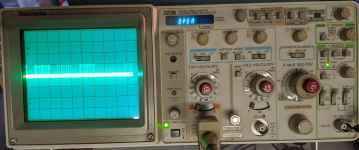

My Christmas present came a week late but finally got here, so I have some better measurements to share. After working with the analog HP it's amazing to use a digital scope. All measurements are taken on the 15 pin PSU connector attached to the PSU PCB, X10 probe AC Coupled. Ground is attached to the body of the metal stand the PSU is mounted on. Like this:
5V Rail:
12V Rail:
-12V Rail:
24V Rail:
The supply heatsink body where the scope probe earth is connected, might not be the same as the common lead outputs from the supply, probably the black wires on the connector ? unless there is a direct connection between the two. However the ripple voltages are much lower and might not be unreasonable for that supply, in short the supply may be ok, are its DC output voltages correct ? It is worth checking on the schematic how & where the supply common's get connected to the metal chassis, they usually do but not always. Sometimes it is in the supply, sometimes elsewhere.
Probably reasonable now to go back and look at the video signal at the input and output of the video output transistor and try to find a reason for the smeared video on the CRT image.
I checked the continuity between the heatsink body and the black wires and it's about .1-.2 ohms, basically a short so that looks ok. I agree, the ripple looks reasonable.

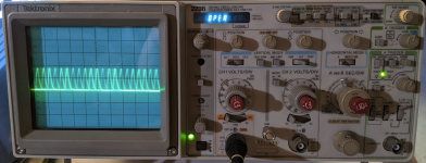

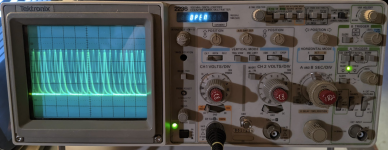

Also, here are some traces from "Point A" at the base of the Q302 Video Amp. I'm thinking these waves (dots on the screen basically) should be more square?
Yes, the video pulses look abnormal and appear integrated. While they would not be expected to look perfectly square, they should have faster rising and falling edges.
At least the scope earth looks good and there is no interference.
Just to double check, since I am unfamiliar with your new scope, can you put the Tek scope back on this test point, with similar timebase settings and try with the x10 probe and the x1 probe too, if you have one, and obviously checking adjusting the attentuator to suit that change to get about the same level and we will check that we get the same waveform.
If this is really the signal at the base of the video output transistor, probably the VDU is ok and the problem is on the video card, and we will have to scope that. Do you have another card to try ?

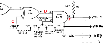

........the video output stage on the card looks simple enough, scope the inputs and output of the 74LS11. Also check what the output on the 74LS11 looks like with the VDU video (link/cable) between the card and the VDU disconnected.

I took some readings on the following points (C, D, E)
Point E (with link cable connected)
Point E (with link cable disconnected)
Point D #1
Point D #2
Point D #3
Point C #1
Point C #2 (this is at the very end of one set of screen signals)

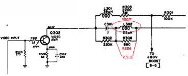

I may have found something. I got to testing all the resistors on the RCA display board in the video signal path. R306 looked like it was shorted, but when I removed the component it checked out ok at 680Ω. It appears there's a short across L302, can these old inductors short out after a period of time? I don't see any other path there. L301 checks out OK.
Edit: I went ahead and removed L302, it is indeed shorted.
Sometimes these low value inductors, in the tens of uH range, can have very low DC resistances. What is the DC resistance of L301 and L302 measured on the Ohms range with the meter ?
It is interesting that the recording at the base of the video output transistor was abnormal, but the output at the IC test point E on the video card looks basically ok, there is the contrast control in between the two points and the cables. Check that the contrast control is basically working and that is ground leg is properly grounded. Check with the meter, the DC voltage on the collector of the video output transistor.
It is acting as though there is additional capacitive loading on the output of the contrast control, in the base circuit of the video output transistor, integrating the signal. This can happen with a defective transistor or open circuit load resistor.
L301 is a shunt peaking coil which raises the impedance in series with the 2.2k collector load resistor R303 (Check this is not O/C), which helps preserve the frequency response of the video amplifier over a few MHz. L302, is a series peaking coil, that is designed to counter the CRT's load capacitance and help preserve the high frequency drive to the CRT. It is a standard combination, as used in most TV sets.

Inductor DC resistance:
  • L301 - open circuit
  • L302 - 2.5 Ohms

OK, this is the problem. With an open L301 there is no significant collector current and no voltage drop across the 2.2k load resistor. This alters the input conditions to the video amplifier transistor, and makes its base circuit just look like a diode. Then the capacitor in its emitter circuit integrates the input waves, which is why they are corrupted at the transistor's base, but ok out of the video card.
So put L302 back in (as it is ok) and for now just replace L301 with a link wire. (there will be a tiny loss of HF response, but basically it should spring into normal life).
