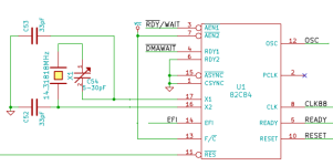

Clearly 14.31818MHz aren’t getting generated (not sure why) and I am not getting anything significant over on EFI. I guess that means the switching circuit is out of order?
The glitch free clock switching circuit requires both input clocks to be running. If one of them stopped, the switching circuit might not function properly...
So, I would investigate why 14.31818 MHz clock is not being generated first.
It appears that your board is using 82C84. Please note that the oscillator circuit for the original (supposedly TTL-LS) 8284 and CMOS 82C84 are different.
You can't simply switch these ICs, without modifying the clock circuit. Particularly, 82C84 needs load capacitors connected between the crystal pins and the ground, while 8284 has two 510 ohm resistors there instead.
Refer to the IBM XT schematic above for the 8284 crystal connection.
Here is the schematic for the 82C84:
The CLK and PCLK look good for a 24 MHz crystal. It is quite possible that your LA cannot sample 24 MHz frequency
Ding ding ding! You won! That was it - the board now lives again. The original 8284 was an M5L8284AP, and it actually had two resistors - while my non-working board had two 22pF caps. Swapped them around and et voilà! The board lives again!
