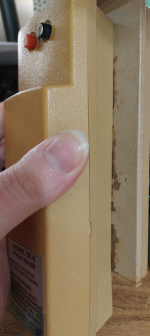

Recently, as part of working on a couple projects, I dug deep into my cluttered storage-spaces and dug out my old UVEPROM eraser and did a tear-down/clean-up.
It ended up being buried deep in my shed when I finally found it. It needed cleaning because it had previously stored in a location that had gotten damp.
Heavily yellowed with heat/age, mild melted spots right next to the UV bulb, and musty-smelling from mildew exposure, but otherwise intact!
For the most part, just a bunch of scrubbing the plastics, sterilizing everything with cleaning wipes, and cleaning out dust/dirt/mildew.
However, one wrinkle did come up after I removed the bulb, one of the bases had come unglued! Then, while I was inspecting that, one of the wires came loose!
Then I had to release the remaining wire (heated the pin with a lighter) and re-glue/re-solder the base back onto the tube.
Had to scrape the filament-wires to get the solder to stick to them, then I poked a hole in an old tube of super-glue and used that to re-seat the base.
A little soldering and it was good as new! Already ran a couple chips through it, 15 minutes should be enough and it didn't get overly warm during that time.
Here's the yellowed old thing, all reassembled- uvp de-4 1.pnguvp de-4 2.png

A pretty simple unit, just bulb, ballast, and on/off switch. No timers or anything beyond the bare necessities.

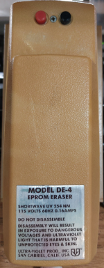

Hi,
I bought a used UVP inc DE-4 EPROM Eraser, but the post link to a manual is at best, half the manual.
What do the RED and BLACK buttons do?

Did you actually read the manual?
"Depress the red button on the upper portion of the eraser for three to five seconds, then release. This will light the lamp."
"After completion of the erase, turn off the lamp by depressing the black button"
Also note - "The lamp will operate, independent of the drawer position, until the lamp is turned off."
That means no timer - when the EPROMs have finished cooking, you need to turn it off yourself.
