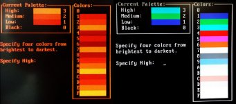

I have a gas-plasma panel being driven off the VESA feature connector of an Orchid Fahrenheit 1280 (1mb ISA card). The panel itself is capable of 16 shades but I am unhappy with the palette grayscaling when in display modes greater than 16 colors. It just goes psychedelic. For example, when I take a 256 color GIF and display it in 640x480x16 mode it looks decent. When it's displayed in 640x480x256 mode it looks like garbage and playing Doom is just nuts. I think it's because this panel is being driven from a regular video card as compared to the Toshiba T5200/T3200sx which have some BIOS support for setting the video chipset modes in a manner optimized for the plasma panel. My guess is that the pallet is wrapping around every 16 shades instead of converting ranges to 16 shades.
Evidently this Fahrenheit 1280 card uses an S3 chipset. The datasheet mentions control registers to set grayscale summing features which, when enabled, I think will convert colors to 64 shades of gray. I plan on messing with that when I have time but ultimately I'm not attached to this particular card and I was wondering if anyone else has had experience with particular cards that may have better support or dos utilities to help facilitate grayscaling?

I've been looking at the datasheet for the palette chip on this card and it's got some interesting things I'm going to look in to regarding palette mapping. I used a utility I wrote for reforming worn plasma panels to check out text mode color grayscaling because the calibration feature displays the palette colors 0-F. I ran it with an external screen attached so I would get simultaneous Plasma and Color output. It doesn't reveals anything useful regarding graphics modes but it was something to do. I'm working on something similar that uses graphics modes which I might try to fast track at least enough to help me get more info.
For kicks I also ran the memory resident Fahrenheit (s3) DOS VESA driver which seemed to give slightly different results in graphics mode but I couldn't quite put my finger on the difference. I'll have to do it again and take some pics to compare.
This is a Dolch Pac machine and I can't help but suspect there was some utility that originally came with these to help with this because it would be kind of silly not to. For now I'll continue reading up on the palette chip controls and features.

Screen shots attached.
So I'm guessing there was no change at all on the plasma while the program was actually running? (The colors didn't flash or shimmer in any way?) That plus the fact that you can't distinguish the 16 horizontal color cells seems to confirm that the only thing you have to work with is a 4 bit nibble of raw from-memory pixel information and the palette is indeed not in the loop at all. Did you try the one that runs in 80 column text mode and verify that it also doesn't cause any change on the plasma at all? (I suppose it's remotely possible that the feature connector could be north of something that can shuffle palettes in the 4-bit modes, but I'm pretty skeptical about that.)
I dug up the datasheet for the CT65540/65545, which has a dedicated on-chip flat panel interface module, and on page 180 it describes the dither options available. (Skimming it it looks like it can fake at least 60-ish shades of gray on a 4 bit panel.) I suspect to get better than what you're seeing you'll need a card with a chip like that. What I'm not entirely clear on from the datasheet is how exactly it translates the RGB shades in the palette register to the available dithers, but at least it does have the hardware to pay attention to the upper bits of an 8-bit pixel instead of ignoring it entirely.
