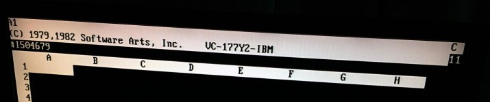

I'm on a physical 5150, I am using XT-IDE with the extended RAM module. I am using DR DOS 3.41 (so 640KB only, no extended RAM stuff).
When I run VC.COM, it does run ok. I can move the cell cursor around.
I can type a label or value. However, when I press ENTER, there is a tone (beep) and the label or value is blanked out.
I noticed at the top right the program is showing "0M" which as I recall means the program thinks there is 0 memory available (hence I assume it is not saving my cell values).
Anyone know what the issue might be? I haven't had memory trouble with anything else (TetraCompositor, Lotus123 2.4, KQ1-4, Oregon Trail, Lemmings, etc.).

Ah, I figured it out (well the cause, not the reason) -- I thought the same initially, that it was related to drive letters or disk drives (my physical machine doesn't even have a floppy controller installed).
You're kind of on the right track - as I recall, the original VisiCalc disk was its own boot disk.
The issues turns out to be related to the contents of the CONFIG.SYS. On my physical machine, I'm loading the SoundBlaster drives CTSB2.SYS and CTMMSYS.SYS.
CTSB2.SYS wipes out all the available memory to VC.COM by itself.
If I just load CTMMSYS.SYS, then VC.COM prints "11" as the available memory.
If I remove them both, then VC.COM prints "27" as the available memory.
[I'm not sure if VC is stating "blocks" or KB or what - but I don't have to type much for this to start decreasing to 26, 25, 24, etc...]

With a newer version of DOS, I should be able to load these drivers into high memory. DR. DOS 3.41 didn't yet have that feature. Maybe there is another way to load those from the command line instead of via config.sys ?
EDIT: I'm not 100% sure why these drivers impact the available memory to VC. I can't recall exactly where device drivers get installed by default in DOS. I do imagine VC.COM is real-mode and maybe can only address within a single segment (tiny model?) -- which might limit it to 64KB total? I'll see how many cells I can populate and if it saves a file over 64K.

That doesn't make sense. Visicalc only uses a single segment (64K) maximum for everything. Running on a virtual 64K machine, I get a Visicalc free memory of 22K which fits with 27K of VC and 13K of DOS; the other 2K being whatever memory VC uses to initialize. You should be getting something like 30+ for free memory. The Soundblaster drivers should still leave a segment completely unused unless you have loaded more than 570K of code before starting VC. You have discovered a very strange bug in either DR-DOS or VC.
Well, the /E environment thing adjusts some memory. I'm not sure what DR-DOS defaults to on that (256 bytes I'd assume? I forget what the max is). But I agree, it's weird those .SYS files effect anything as far as VC is concerned. DR-DOS's COMMAND.COM might use a slightly different amount of memory also. But nope, not loading any other TSR or anything - config.sys and autoexec.bat both empty and just loading VC.COM.

Early software has all kinds of crazy bugs. Some programs will complain about insufficient memory if they see more than 512k, some only like certain versions of DOS, some make assumptions about BASIC being in ROM, some assume certain software interrupt vectors are never in use, some bypass DOS and expect a FAT12 or small FAT16 partition, some use FCBS in such a way that larger FAT/FAT32 file systems won't work, many require large FILES= to be set in config.system.
I just tried the same version of VC under windows 95 and I get seemingly random numbers for "free" memory depending on how I launch it. Perhaps a value "wrapping around" somewhere if it thinks a machine can't have more than 64k?
I think I've figured it out, maybe. When I run the version of VisiCalc that's on Dan Bricklin's website (the link in the OP) says it has 88k free on my Tandy 1000 SUX under PC-DOS 7.0. This machine is all tweaked out with upper memory block support so I normally have a whopping nearly-631K free at the DOS prompt. 128K minus 9K minus 27K = 92K is suspiciously close to 88K. So...
I have the program "EATMEM.COM" on my system, so I decided to try and see what happens when I move the base of DOS memory up. (EATMEM.COM occupies a chunk of lower memory like a device driver or TSR, it doesn't do the alternate thing of moving the BIOS top of memory *down*.) I first tried "EATMEM 256", which swallows up RAM up to the 384K mark leaving 256K of RAM free. With this set you can run VC.COM but it says it has zero bytes free, despite 256K being more than enough to run this program. Changing to "EATMEM 512" doesn't fix the problem: it still reports zero free memory. However, if I do "EATMEM 576" starting VC will result in 34K free memory being reported. 64K minus 27K =37K. It looks like VC uses 3-4K for its own purposes...
To cut to the chase it looks like VC.COM is using some broken version of small model programming where it's able to use up to two 64K segments worth of memory, but only memory between 00000H and 1FFFFH. DOS is able to load the binary higher than 1FFFFH but apparently VC.COM gets really confused by this and continues to think that it can only store data below the 128K mark. I can totally believe that DR-DOS 3.4 with all those Soundblaster drivers loaded might occupy more than 128k of RAM, so, yeah. Boom.
