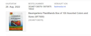

WARNING: Clear QIC Tape Bands
That's after sitting parked a couple months. I have a Dysan doing it too. The Dysan had been re-banded with a boiled 3M band and run for years like that with no shedding. I have another Dysan with a green Plastiband in it which is also fine, minimal/no shed. So, I think we may need to re-evaluate if the clear Amazon cheap "plastibands" are perhaps totally incompatible with tape.
I know, I know..."just use the band to get data off." But I want to *run* QICs without having to destroy them constantly.

Some month ago I ordered plastic bands as shown at https://www.vaxbarn.com/qic-tape-data-recovery
and put the 6" into a jam jar for some weeks as I had 1st to bake some tapes.
The plastic bands where broken, maybe it was a bad clone of the original bands,
Off course I was pissed of so I used some bands from good old memorex tape I tested a week ago.
With it I save 3 QIC tapes error free for my Siemens Sinix MX300 system.
So why did the new plastic bands fail?

Those plastibands age badly, so it depends on how long they've sat on a distributor's shelf. LIke Al, my goal is not to make tapes usable past retrieving what's been written on them. After that, it's the bin.
Could be, the green Plastibands I put in QIC cartridges around two years ago are still OK. I'm using them in tapes that actually get used, one of which is my "test unknown QIC drives with this" cartridge.
