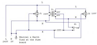

Yes if the center tap of the secondary is connected to the neutral side of the of the 240V this will cause all sorts of problems. If center tap of the secondary is connected earth, and earth is connected to the neutral at the fuse board, then essentially you have the same circuit, no?
Leaving it to float, is an option, but isn't the 120V-0V configuration effectively the same as a US outlet now?
You don't want the center tap connected to anything. But yes 120-0V with the 0V connected to the ground lug--and earthed, is essentially the US system. Remember the US distribution:
120-0-120, with the 0 also earthed. The 0 side is the wider of the two prongs on a USA plug--don't get those mixed up. So the wide prong in US outlets is connected to 0, with the 3rd ground prong earthed--usually, the two are connected together in the breaker panel. The narrow prong on the US plug is connected to 120V; it doesn't matter which side of the distribution transformer winding.
US electrical code requires an independent conductor for the grounding prong, even though it may be connected to the neutral side of the line in the breaker (distribution) box. Safety is provided by a GFCI (if the fault circuit interrupter detects that the current between the two flat prongs isn't the same, the circuit is interrupted.) So, tossing a hair dryer into the bathtub will cause the (now code) GFCI to trip, regardless of what the TV murder mysteries say.

Hmm, sorry, Chuck, no one is suggesting placing the protective ground prong at 60 V. Ground is still grounded.
I guess I'm not following the conversation well, then. I see the low end of the 120V "neutral" and then I see the ground prong (chassis ground) hooked to the center tap (60V above neutral) US convention is neutral-ground.
I'm wondering if the setup will create issues with ground loops. Maybe I'm fussing about nothing.
Yes, mR_Slug's wiring diagram is slightly misleading schematically, functional but not ideal if it's really wired that way.

I'm looking at the drawing, if the switch is set so that the external ground
is connected to the sockets neutral, the ground on the plug will be at
60 volts.
Most equipment connect that to the physical chassis.
If one set that on a grounded surface, it would short out the 60V output of the transformer.
I would not wire it in such a configuration.
I see no big issue with grounding the center tap but the circuit as drawn
is really dangerous.
Dwight
Took me a while to understand what you mean. Unless I have missed something you must be referring to the first diagram I drew in post #18. Yes the diagram in post #18 is very very wrong. I have updated it in post #20.
On second thoughts, would it not make more sense to bond the neutral of the 120V to the neutral of the 240V?
Like this:

I didn't notice the changed diagram.
The only issue is that most switches on the power supplies
only switch the hot lead.
If someone though turning it off at the switch was enough to
poke around, a screwdriver or a ring on ones hand could find
the 60V to ground.
I do like the idea of the balanced voltage for other safety reasons.
One could still manage to kill them selves with 60V but it is
safer, as you mention.
Dwight
Like this:
Umm, no. Like any other modern appliance, treat the Neutral on the incoming 240VAC as though it is "hot" because it's potential is not entirely certain. You might encounter a reverse-wired plug or overload at another point in the household circuit where that current raises the potential on N. Same reason why 240VAC appliances often switch both sides of the mains.
On your schematic you need to remove the link between the incoming N and ground since that link is not part of the transformer assembly wiring between it's 240VAC plug and the two outgoing sockets. I also note there are no fuses and you might check to see if the transformer core is tied to ground as well.

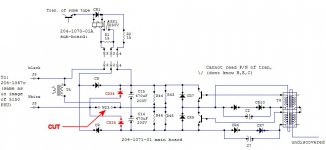

Well I got the new transformer. I folded over the pins, and soldered the two 6V windings together and did the same for the two 120V, giving a 240-12V configuration. Then I lightly touched one of the other pins, and it broke off immediately. So I managed to solder on a lead further back where the winding connected to the pin. It turned out that my measurements were wrong, and I needed to drill 1 new hole in the PCB. So anyway I did all this, got it all soldered in, was very pleased with myself, patted my self on the back, until I realized I'm an idiot.
The negative side of the transformer doesn't connect directly to the negative coming in. It DID previously, but because I had removed the W23 jumper, now it just connects to the center of the two main caps. No one could have advised me of this, because my schematic was incorrect.
So my intuition on reusing the 120V transformer was right, but my schematic tracing skills need more work.
Anyway the end procedure is really quite simple, remove W23, solder in diodes at CR34 and CR35.
Updated schematic

I found a couple errors on the final diagram. The diagram didn't show W23 connecting between C14 and C15.
This one has some fixes.
My board is -03 , not -01, but they are probably the same in this regard.

-Install diodes CR32 and CR33
-Remove jumper W23
-Replace T5 (115/12) with 230/12 one that fits
And by my guesses on the filter board:
- Replace X2 caps with 275V+ rated ones.
- Replace 300K resistor on filter board with 560K resistor.
- Replace 4A fuse with 2A fuse.

I've successfully done this conversion on a 5160 PSU of mine.
My board was the -03 version instead of your -01 version, but it's nearly identical.
Exact procedure, to clear things up:
Parts list:
- 2 x 1N5408 diodes
- 1 x 10ohm 5W resistor
- 1 x 560K 1W resistor
- 1 x 2A 250V 3AG-size fuse
- 2 x 100nF 275VAC+ "X2" film capacitors
- Torx T10H security-bit screwdriver
- ~7mm nut driver
Procedure:
- Install two 1N5408 diodes at CR32 and CR33 empty holes. (May need to drill holes slightly bigger)
- Remove jumper W23 next to J3.
- Replace R1 (2ohm 5W) on the relay board, with a 10ohm 5W.
- Replace the main fuse (4A 250V 3AG-size) on the AC-input board, with a 2A 250V 3AG-size one.
- Replace the 300K resistor on the AC input board, with a 560K 1W.
- Replace the two X2 capacitors on the AC input board, with ones rated 275VAC or higher.
Test that you still get between 9 and 12 V AC on the secondary of T5 when mains is applied.
A test load is needed to test the power supply. One 3.5" drive was not enough for me. A 5.25" drive was. Maybe two 3.5" would be.
