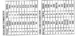

This new machine to me, Sharp PC 6220 has a Connor 20MB HDD which is working, but I think it probably wont last.
I have a spare xt-cf card for my zenith Z171.
I would like to simply wire in thi xt-cf and gain a compact flash port with minimum efforts.
There isn't an actual isa port, but the signals all exist on an expansion connector.
I wasn't thinking to replace this drive with a CF card, but rather to add a CF card. But, fair enough I could just replace the 20MB drive with something else.
The PC-6220 uses a 20MB Connor drive, which has 50 pin interface.
The below page is from the service manual, which describes the 50 pin interface for the Connor 20MB drive.
There is a special flex cable that connects the drive to the main PCB. It connects into two sockets on the motherboard.
Those pinouts are here.
