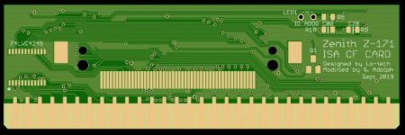

So I started a project to create an XT-CF card based on the Lo-tech design a month ago.
Making some progress.
First major issue was that the "standard" ISA port on the Z170 is not well documented (in the user manual and the service manual)
* it is wired backwards relative to the standard port, so my layout was a mirror image of what was needed
* power pins are not correctly documented
Despite those setbacks I have now got a flashable card installed in my Z171.
I'm now debugging the specifics of the actual bios used, the settings, getting an FDISK.COM that works and recognizes the HDD etc etc.
I'd be interested in seeing your schematics and slot documentation if you share them. I had to do (probably similar) adaptations for the cards I've been making for the "PLUS" bus in my Tandy 1000 EX, which is likewise ISA-but-*not quite* on a different connector.
I've been able to get something working reasonably well, with caveats.
* while it is possible to use DOS newer than 3.1, newer DOS tends to not work great with the floppy drives in the Z171. Recommend sticking with stock Zenith 3.1 MSDOS.
* start up of the machine suffers from a defect which may or may not be resolved. Basically, to boot up or reset the machine you must power down for 10 seconds, boot once, soft reset before boot attempts to read from CF card, and then let the next boot proceed. It is a bit clumsy but manageable.
* I'm using R602 XUB firmware
The ISA socket is wired up mirrored relative to the standard card. This means I need new PCBs.
I'll have to post the PCBs with instructions at Oshpark when the next boards are verified.

Yes that is the point of this project. Compact flash "HDD" . Its working well with some simple rules for how to power up and reset. I have a new pcb to test out due to the reversed pinout of the connector. Saw you changed to NEC V20. Is that a VMOS CPU?
Yah thanks. Checked that datasheet and it is 10mA per MHz like the 80C85...so seems like a good upgrade.
Here is the primary side of the new PCB for this thing.
The idea is that when it is installed (BTW - the RGB Video board can't also be installed!) in the main board connector, it is flush with the case. When the CF card is inserted, the Card itself will protrude out the back of the case so you can easily insert and extract the card.

Here are some pics of the final version for those who might be interested. Big thanks to Lo-Tech for sharing schematic and the XUB team for the firmware. PM me if you are interested in having one of these.
In the pics below you will see a black wire that loops around. that is there to help me pull out the board once it is installed. Not really needed, but when I was debugging things I did need to extract it. As you can see, the board is flush with the back of the PC and only the CF card pokes out.
I would say that some care would be needed not to damage things by impacts on the CF card. While convenient to be able to mount and unmount the card via the exposed socket access, it's not the most rugged.
This board has no jumpers but it can be configured the same way as Lo-Tech's card. It has an activity LED which is helpful but a good hack would be to add an LED to the case so you can see the LED from the front while working.

schematic is here for reference. Note there is one barnacle on this board that needs to be done. Schematic does not reflect that.
