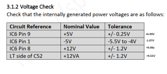

Ok I did some checks. In regards to IC 15 and Dave you mention of +15V I am in agreement it should be +5V and that is what I am getting.
Using the schematic, I am getting 9.8V from R59, D15, and R62 (so my 12V rail is a problem).
I am getting +10.4V from C46 where the schematic says I should be seeing -12V so I dont know if the schematic is wrong or my board is.

It looks like your +12V and (by inference) +12VA - is too low. This could affect the DRAM and the video circuitry.
I still can't see where -12V is used - but I do agree (now I have looked at the schematic again) that the schematic does look a bit suspect.
I would guess that -12V should be at the junction of C46, D11 and R55 instead of where it is shown. Is the -5V rail OK?
"I would guess that -12V should be at the junction of C46, D11 and R55 instead of where it is shown. Is the -5V rail OK?" So yes the 5V rail seems to be the only power voltage that is ok.
I am not getting anything resembling a -5V rail at C46,D11, and R55.

What do you see (using an oscilloscope) between TR4 base and emitter (gnd on emitter probe on the base) and TR4 collector and emitter (gnd on emitter and probe on collector)?
TR5 (in conjunction with TR4) is an oscillator - fed from a 5V and 9V supply. If it is not oscillating, you will only get +9V (or so) fed into the subsequent circuitry (which seems to align with your faulty readings).

I did the voltage check in the service manual on page 17 and these were my results:
Just thinking here. Some the the transistors I received were not exact matches of the originals. I am wondering if I put a few of them in backwards.
