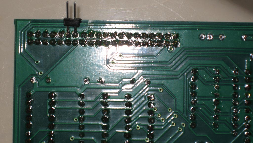

That seems like the CSEL issue that I was playing with over the weekend.
If you've got a soldering iron handy, I can step you through the process of pulling CSEL low. It was pretty easy to do.
that fixed my drives showing up as slaves issue 100%.
There is a pull up resistor on CSEL so if you want just solder a jumper between CSEL and ground. The pull up resistor will limit current to very small amount. Alternatively, remove the resistor and just ground CSEL directly.

It is important to not just replace or bypass the pull up resistor with a jumper. The resistor is there to limit current flow and wire will not do that. A plain wire would short VCC to GND and the power supply will not come up.
Actually, you can just leave the resistor in place. Just connect the CSEL pin to ground and the pull up resistor will be OK as is.

Hi Hargle! That's great! Pin 30 is GND so that's convenient!
Nice mod! Cool points for Hargle!
