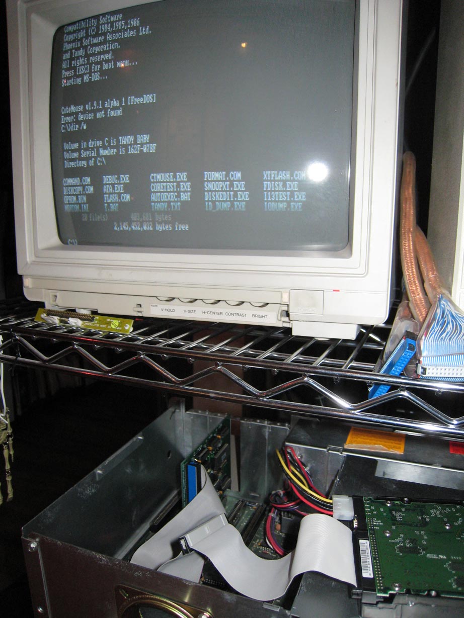

Anyway, good news for kb2syd:
[I posted a message about this earlier, then deleted it as it was confusing because of my own silliness. Here's the real news:]
XTIDE rev 2 cards work perfectly in the Tandy 1000SX. I got a machine from Agent Orange, dropped my rev 2 card with 010 BIOS on it into the machine and booted to the hard drive. Simple.
I have 1 drive attached, a WDC-WD80EB-28CGH2 from an old xbox 1. (8 gig) and it recognized it and booted to it. I'd previously installed DOS on it.
The card is at defaults of D000:0 and 300h for IO.
The boot menu works fine, although I can't boot to ROM BASIC (I assume it doesn't exist on this machine), but I can boot to either A:, B: or C: from the menu as expected. It's working perfectly.
The ROM is currently write enabled, and I've rebooted and power cycled the system a half dozen times without error. Granted, all I've done is boot to DOS and did a "dir" to the C: drive, but yeah, it's all perfect.
here's a pic:
http://www.waste.org/~winkles/tandysx.jpg
