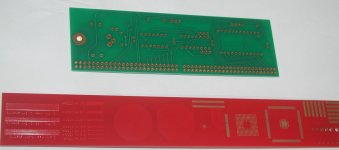

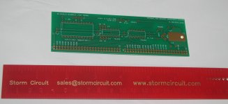

The good news was the the pcb's for my PET memory test system/project arrived in the post. They are Gold plated types, beautifully made. In this case the PCB maker was Storm Circuit in China. The owner, Mr. Kim Chan is super helpful and he was able to convert my old school .jpg artwork into Gerbers and make these boards.
He also gave me a cute pcb ruler with various track formations and sizes. His company also makes very highly detailed multi layer boards for various research institutes and Universities. And they have a very quick turnaround.

Gary C
May 26, 2018
2,134
Lancashire, UK
Interesting
Will the Gerbers be available generally or would we have to order via storm ?

Hugo Holden
Dec 23, 2015
4,214
Australia
Interesting
Dave, did you have a good day ?
I was snowed under. You might have heard the tannoys about problems with the Fuel Handling building H&V :)
I'm not sure. I have not figured this out yet, if it is the pcb company makes the gerbers, if I own them or they do. I will ask. In any case it is a very simple pcb thankfully.
