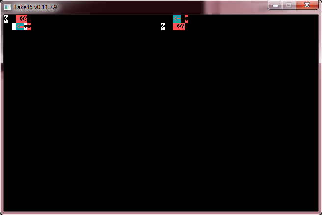

Found a bug. I booted up and played Wolf3d for a few minutes. I then quit to dos, entered "mem" to see how much memory was available, then ran windows. I simply exited after it came up. I then ran Qbasic, which loaded fine, but on exit I get a mess.
"DIR" here scrolls garbage in those first three lines.
I ran Qbasic again and it came up ok, but on exiting, I ran MSD and the machine appears to be locked up.
I just restarted it and ran Qbasic first off. On exiting I get the same garbled top screen.
g.
yes, i also have run into the MSD bug, and i'm not yet sure why QBASIC does that on exit. i've found typing MODE CO80 fixes it, but it really annoys me. i'd love to find what's going on here and will try.
