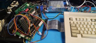

Well, that's your problem, not mine - mine has an external industrial ISA backplane extender - Adlib, MPU401, VGACard, 1 MB RAM, and yes, XT-CF-Lite. Euro PC. I believe that file transfer with a modern computer is a bit more intuitive with a CF card than with a Zip drive (heck, does a "modern computer" have a parallel port? oh, that's right - it doesn't). With an external industrial ISA backplane, there are no limits on extensibility whatsoever.

It's not that bad... I can just pull the ISA connector plug on the left, and then it's pretty easy to transport as well. It's not worse than transporting a ZIP drive ;)

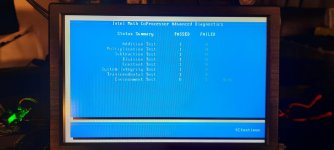

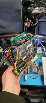

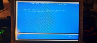

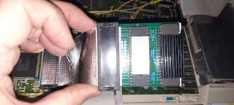

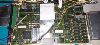

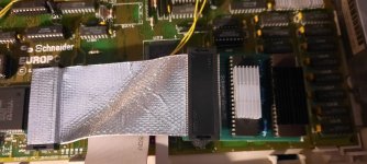

So, I installed my CoProcessor - it works, but the Intel Test Program reported an "Environment Error" and that it isn't installed correctly. Also, I couldn't observe a proper speedup yet. I have not wired up the NPINT to the Faraday chip. Maybe that's the problem?
20250207_184304.jpg20250207_184321.jpg20250207_184335.jpg20250207_184344.jpg20250207_185139.jpg20250207_191354.jpg20250207_191423.jpg

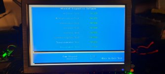

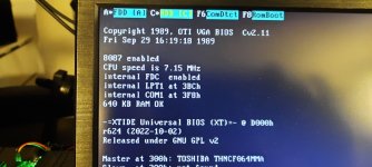

Oh! I had the wrong test program! The second MCPDIAG program from this thread seems to think that my 8087 is installed correctly!

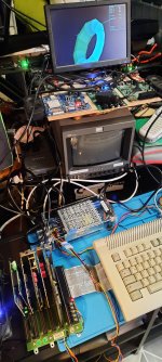

I was now able to measure the difference / speed up, and it's indeed a factor of ~8 to 10 for my graphics program.
(Sorry, German only, but you can see the speed difference for the test program with and without 8087).

Supposedly the "Environment Error" shows up if you don't add the command SET 87=YES to your AUTOEXEC.BAT file. However, I did so on my Tandy, and the Intel test utility still gives me that error.

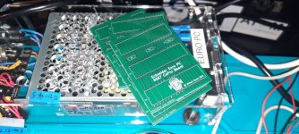

... @1ST1 since you already voiced your dissatisfaction with the prototype layout - doing one more round, hopefully you'll like this one better :D
