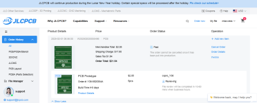

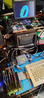

great find thanks! Good to know my use case on Z171 isn't necessarily defective. The thought of disassembling MCPDIAG is unappealing. After reading that application note for 8087, it seems like the best option for dealing with the interrupt may be to leave it disconnected altogether.. since there is likely no facility to deal with MCP exceptions via software interrupt built into a machine that was never intended to support a math coprocessor. My current dual socket adapter is a hand made thing; not the cleanest implementation, and I notice some ringing on the datapath.. I may spin a small board to see if better signal quality, and possibly that is related to the strange MCPDIAG test results. Stab in the dark but a nice board is better anyhow.
Next project-- convert the Z171 from 640kB of DRAM into 1MB of SRAM. Next Next project... increase clock from 4.77MHz to 9.54MHz.
