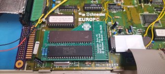

I should probably have it in a shrine / glass vitrine in my living room... anyhow, I think that it is doing better than on a dump in China from where I got it, basically, even though if it suffers from my rude onto-board soldering.Looks very rude to solder an 8087 directly to a PCB.

Hi, actually for the Olivetti M19 the 1st design would be a better fit I think. Is that technically the same? Or did you improve on that in the final design?
The initial flatcable based design is not running very stable because of the signal length.Hi, actually for the Olivetti M19 the 1st design would be a better fit I think. Is that technically the same?
