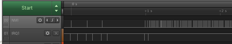

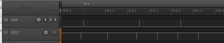

Keystrokes at DOS prompt:
This is D I R keys
For each key, IRQ1 fires, then NMI fires, thjen IRQ1 fires again.
Here is something more interesting - NMI fires when the screen is being updated.
Here is a trace of
D I R <enter> - 4 keystrokes followed by a bunch of screen updates.
Interesting .. implies that NMI, from the "keyboard controller" has a screen update component to it.
In the case of keystrokes at the DOS prompt - that is both a keystroke detection + a display.
