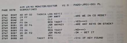

Good morning
I've got this manual, but I'm having trouble finding the locations listed.
Random example, I'm trying to find page 2764 B0B1 = 20 22 F6
There are two places with this sequence, but none match the notation B0B1
I also managed to fix some of the broken pins of the address decoder and replaced the socket. All inputs are looking like a pulse and there is now activity on pin 20 of the monitor ROM
Maybe I could plug the display back in and see if something is happening
>>> Random example,
Rather than picking a random location, why not look at the first few bytes to start with?
Yep, give it a go. You may get lucky!
