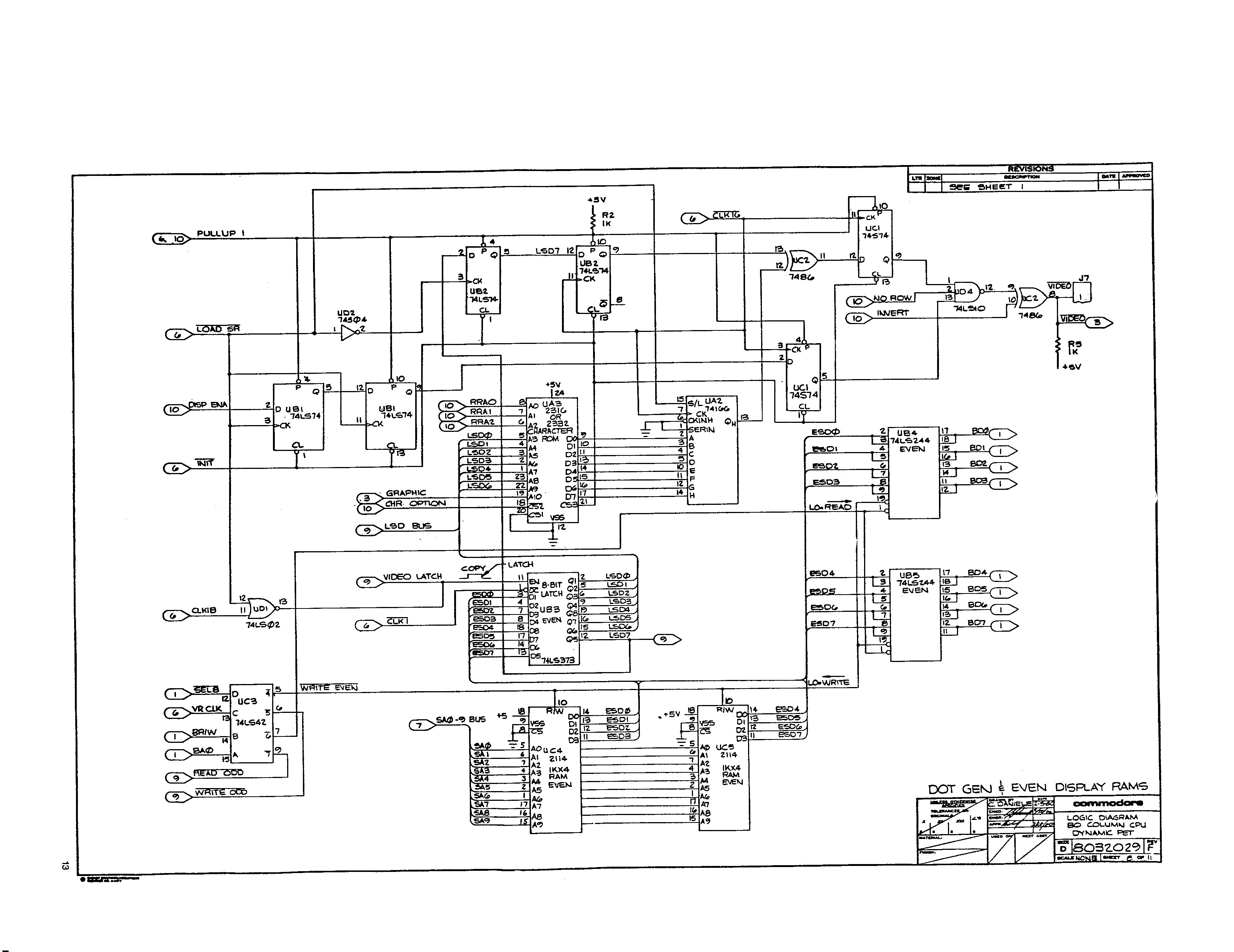

Had some chips in the wrong places, but got that sorted, and now I get this screen. Ah, this is obviously bad video RAM, so I replaced the 4 2114 ICs, and...same thing! Hmm...
PETTESTER seems to indicate bit 3 is stuck low? Does that look right to you folks? Where to poke next? I can use a scope, but I'm pretty much a hack. Any ideas to get me on the right track?

It could be a faulty data bus buffer. I think there are two (2) sets of data bus buffers in series between the CPU and video RAM, so these can be faulty in a variety of combinations.
I am out at the moment, but I will have a look at the patterns when I get back.
As this is an 80 column PET, you have odd and even video RAM to contend with, so treat each alternate byte as unique and look at the patterns independently.

You are 100% correct about my PETTESTER identifying data bit 3 stuck low :)...
On the basis that you have exchanged UC4 for a good 2114 RAM device then it must be UB4.

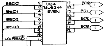

Your problem appears to be limited to the EVEN VRAM and data bit 3 - which is UC4 (assuming I have found the correct schematics for your machine).
If it is not the RAM, then it must be the D3 data bit supported by the UB4 '244 data buffer.
It can't be the data bus buffer closer to the CPU, as this would result in faults in both the ODD and EVEN VRAM.

Thanks Dave! I'm not 100% confident about the status of my replacement 2114s, but moving them around doesn't change anything, so I think it's good. So that leads me to UB4. Sadly, being in the US, I'm currently at work for another 5 hours, so I'll get to it tonight and report back. Sounds like you've got the right schematic....here's the one I'm working from: http://www.zimmers.net/anonftp/pub/cbm/schematics/computers/pet/8032/8032029-08.gif

@daver2 , you called it again! The LS244 at UB4 fixed it. I'm not sure I understand how that LS244 buffer works I could clearly see a changing signal coming in and coming out of the pins corresponding to bit 3, where what I was expecting to see was no signal. Regardless, that was the fix. Oh and I didn't have an LS244, but I had an HCT244 that works fine. That was an easy one, relatively speaking. Thanks again for your help! Still have to check cassette and IEEE operation, of course.
I may plug that old IC back in and compare signals and see if I can see what's happening on the scope.

You must remember that a 244 buffer is bidirectional - meaning it is used both in read and write mode. Different gates are used internally - so you may get confused if the chip is 'half working'.
There are two separate active LOW enables - one for READ and the other for WRITE.
You could use a 2 channel scope and look at the signals only when the appropriate enable is LOW. This should identify which 'half' of the chip is broken - as you should find that one (or more) data lines are then stuck (low or high) when looking only at the correct time.
Try it with the old chip to see...

@daver2 , I finally got around to plugging in that 244 at UB4. I ended up comparing the output of pin 9 from the bad IC to the good one. While I had seen what I thought was a 'good' signal on the bad IC, when comparing the two, it turns out they are inverted! So that's what was broken on the original IC. While I admit I don't understand how the LS244 works, especially how it's wired in this circuit, it appears to me that the output was supposed to be inverted when it wasn't, or vice versa. But I needed to compare it to the working one to see the difference.

The way to think of it is as follows:
When pin 1 is LOW (/READ), the CPU is performing a READ from the video RAM and the data present on ESDn is transmited onto BDn.
When pin 19 is LOW (/WRITE), the CPU is performing a WRITE to the video RAM and the data present on BDn is transmitted onto ESDn.
When both pins 1 and 19 are HIGH, the buffer UB4 is disabled and no data flows between the ESDn and BDn busses.
If pins 1 and 19 are both LOW at the same time, we have a problem - as data is trying to flow in both directions - and we end up with a complete and utter mess!
Trigger the oscilloscope on pin 1 being LOW (/READ) and then look at the signals present on ESD0 and BD0. Whatever is present on ESD0 should appear (unmodified) on BD0 (but ONLY when pin 1 is LOW). Repeat for the other signals n=1, 2 and 3.
Trigger the oscilloscope on pin 19 being LOW (/WRITE) and then look at the signals present on ESD0 and BD0 again. This time, whatever is present on BD0 should appear (unmodified) on ESD0 (but only when pin 19 is LOW). Repeat for the other signals n=1, 2 and 3.
The SN74LS244 is a non-inverting buffer so the output should equal the input (when the buffers are enabled).
