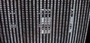

I think, last year, during my attempt at upgrading the memory of my Macintosh 128k, I accidentally killed the 68000 CPU.
My reasoning is that the system no longer gives me the bell tone at startup (now a bad staticky screech), and the video is extremely garbled.
Even trying to use a 512k ROM set gives me bad images, even worse than before.
Should I clip out the old CPU and replace it?

By the way, this is what I got when I first powered it on after modification:

Why do you think that the symptoms indicate a CPU problem? What did you replace in your upgrade? If it was working before you messed with it, my first guess would be that the new improved parts, or installation of same, have some problem. The fact that it's trying to make a beep and trying to show the unhappy Mac on the screen makes me think the CPU is functioning quite well.
All these symptoms sound like messed up RAM, not the CPU. In the original toaster mac the sound generator works in concert with the video refresh hardware, in that the sound buffer is directly DMA'ed and played out through a (pretty crude) DAC. The same RAM problems that are trashing your screen are thus also trashing the sound.
What made me think it was the CPU was that the RAM tested fine. (I did test the CPU, I think, to see if the data lines were disconnected accidentally.)
Maybe, as some have said in the past, there was a specific RAM precision problem that the tester could not pick up on.
Yeah, it looks like a RAM issue that just affects one byte. I can't tell if it's the high or the low byte from the pic in #4, but it looks to me like the garbage is 8 bits (pixels) wide... The alternate columns look mostly OK though there are still a few glitches in there.
I'd check for solder bridges - visual check first, but then buzz out the address and data lines with an ohmmeter (assuming you don't have a logic analyzer available) and see if there are any shorts...
I suspect the address multiplexing is also damaged, given how bits of that sad Mac icon are scattered/duplicated around the screen. I do think you’re right that one of the banks isn’t getting read or written properly at all based on the “perfect” repeating columns of random garbage in between the “merely” garbled and misplaced stuff.

To me it seems like the first thing you should check to rule out you baked the motherboard while heat-gunning off those Apple chips is, starting from one end of a row of memory chips, stick a continuity test probe into each pin of the first socket and then make sure you get continuity from that to the same pin in the next socket down the line. All pins except 2 and 14 should be in parallel in each bank; any gap and either your socket soldering is flawed or a trace in the motherboard got smoked. If *all* of those connectors pan out then you can trace the D and Q lines; for those I'd need to look at a schematic for the machine as to where would be reasonable places to probe for them.
And then, if that all pans out, then I guess we could start tracing the CAS and RAS lines to the multiplexing circuitry. Methodologically tracing this all backwards is the only way you're going to find the problem at this point.

I go back to the screen shot that shows one byte being (mostly) OK and the other byte being the bad one. It would only take one stuck address line (or enable line) on one chip to cause that behavior. It's unlikely that it is being caused by two address lines shorted together, as that would affect both bytes. Since all the address lines are in parallel for the 16 memory chips, I think the most likely case is a broken trace or bad solder joint on one of the memory chips. If we could determine whether it's the high or low byte that's bad, we could reduce the number of chips to check by 1/2...
Decoding circuitry is not likely to be the problem as all 16 RAM chips are enabled together. The CAS signal is different for the two bytes, however, and are generated by a PAL (1D).
Flexing the board is not likely to help locate the problem because the problem is not intermittent.
Blocks of the Sad Mac icon are being repeated in both the horizontal and vertical directions on the bank that's *not* broken, and since it's entire byte-wide chunks of the icon that are duplicated there is definitely something like a stuck address line affecting the whole bank at work here. In theory at least by doing a little math based on the positions of the repeated block patterns (like, for instance, how we see that same chunk of mouth and nose repeated some distance below the center of the screen, or how the right side of the Mac is doubled "immediately" and then repeated again some distance away) compared to what pixels *should* contain those dots (and where they would lie in the memory map) you could probably make an educated guess which address line is stuck, and whether it's before or after the multiplexer.

Ah, yes. Well spotted. I think we may be looking at more than one address line being a problem - one affecting just one byte and the other possibly affecting both bytes.
Horizontally, it looks like it repeats every +1 and +8 and/or -7 and -8 words. Vertically, it looks like +7 and +8... I'd start with the 8, which would relate to A3 or RA3F from the schematic. It looks like RA3 is generated by IC 2F, a 74LS257, or the 74AS253 at 3F (depending on the state of the DMA signal) and becomes RA3F after passing through a 47 ohm resistor in RP2...
Me, I'd be inclined to drag out my logic analyzer to understand what's going on...
