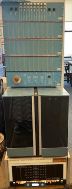

The Rhode Island Computer Museum just received a Classic or Straight PDP-8 and DEC Lab System donation from Sonny Monnosson's Boston Financial and Equity Corporation. It has an American Used Computer inventory tag on the back. The tale is that Sonny received a PDP-10 as partial payment for consulting services, and started American Used Computer to sell it. I will post more pictures after an complete inventory of the Flipchips.

I did some more investigating on the PDP-8 this afternoon. Doug reminded me that there are early and late versions of the Maintenance Manual, and they have some design changes. Since this is S/N 13 it is probably an early version.
There are a bunch of empty slots because the #183 Memory Extension Control and #188 Memory Parity options are not installed.
The FlipChips in slots MA30 through MA25 match the F-87 manual.
MB31 through MB25 match the F-87 manual.
MC31 through MC06 match the F-87 manual except that it has a B684 in slot C19 instead of a B602.
MD30 through MD06 match the F-87 manual except that it has G203B Memory Selectors instead of G209.
It looks like a G209 is an upgraded replacement for a G203.
ME28 through ME14 match the F-87 manual.
MF28 through MF15 match the F-87 manual.
There is an R405 in MF29 and an R303 in ME29 that is not in the F-87 manual. There are a bunch of white wires going to the R303 in slot ME29. There is one white wire going to Pin D of the M405 in MF29. There are three wires that go from the slot ME29 to the Processor side. There are many white wires on the processor side. I will need to make a schematic all of the white wires and additional FlipChips so we can determine what this modification does.
There are a bunch of broken pivot pins on the front panel switch paddles.
The acrylic covers need to be glued back together.
The R405 is a crystal clock. The customer orders them with a crystal somewhere between 5kc and 2mhz. Pin D is the output. The output is a 100ns pulse that occurs at the crystal frequency. The R303 is an integrating one shot. Probably the output of the clock board triggers the one shot to generate a pulse that is long enough to be used somewhere else. It will be interesting to discover all the modifications made to this machine. I don't know how common mods were to these machines but I know it was occasionally done.
Send me the paddles and I will fix them. Or you can 3D print my paddle drill jig and drill out the broken pins yourself. I used acrylic rod from a craft store but I did try piano wire. The downside of piano wire is that the next time it wont be the pivot pins that break, it will be the irreplaceable switches. The drill jig was designed for the 8/e switches but probably works on the Straight 8, 8/S, and 8/L paddles as well. Probably some of the PDP-11 paddles too. But I don't know for sure that they have the same exact geometry.
