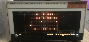

We think that this system has not been powered for about 50 years, so we removed the H708 power supply from the chassis. The system gets really top-heavy and unstable without the power supply installed. We inspected everything for damage and leakage, reformed the capacitors. and checked the diodes and transistors. We connected it to an AC source through a Variac, and slowly ramped up the AC voltage over about an hour and monitored the 6x output voltages. At about 45% voltage the POWER OK relay chattered and closed. At about 65% voltage all of the output voltages looked reasonable. The Margin Supply actually worked as expected. We reinstalled the power supply and turned the system on. Five if the six fans spun up and some lights on the front panel lit. All of the control switches on the front panel do something. The LOAD ADDRESS switch looks like it is actually loading the switch settings into the PC.
We printed Doug's front panel switch handle drill fixture. This week I will drill out the broken handle pivot pins. I bought some 1/16" acrylic rod on eBay to use for the replacement pivots.
Next week we will determine how many of the bulbs on the front panel are burned out and replace them. We have just a few spare original bulbs. We will also take detailed notes on the switch behavior and start debugging the system.
