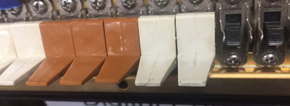

Resoldered a broken wire on the PANEL LOCK switch. Testing the front panel switch functions. LOAD ADDRESS works as expected. The SWITCH REGISTER switches need to be cleaned. All of the bulbs in the PROGRAM COUNTER and MEMORY ADDRESS work. EXAM makes the PC and MA count up when the switch is pressed. DEP makes the PC and MA count up when the switch is pressed. and the MEMORY BUFFER contains the switch settings. A subsequent EXAM shows the memory to be all zeros. Bit-3 in the MA is stuck on. Lots of work still to do.
It is 1/16" or 0.0625".
I have have lots of 0.0625" diameter Acrylic rod now. I measured the diameter of the very warn pivot pins, and they look closer to 0.050". I will try the 0.0625" Acrylic rod in the metal brackets on the switches before I drill the switches. Hopefully the existing pivot pins are just very warn.
I also got the new bulbs from DigiKey. From my initial testing all of the PROGRAM COUNTER, MEMORY ADDRESS, and MEMORY BUFFER lights are working.
I tried the 0.062" Acrylic rod in the metal brackets on the switches. It is a little loose in the holes, but a lot tighter than the original pivots on the handles. This retrofit should work great.
I tried drilling the broken handles with a 1/16" drill and the 1/16" Acrylic pivot rod would not fit in the drilled hole. I tried a #52 (0.0635) drill and that fit much better. The diameter of the Acrylic rod is not too consistent along it's length, but it should work just fine.
Thanks for sharing the design of the drill fixture. It worked great!
Glad to hear it!
I think I used a #51 and then a drop of superglue to hold the acrylic rod in place.
The fit of the 1/16" acrylic is better than the original pins. If you wiggle the paddles the repaired ones are much less sloppy.

This is really fiddly work. Some of the pivot holes were drilled about 0.030" closer to the switch than original pivots. After installing and trying the fit, I found that I had to carve a little plastic off the switch to make room for the metal bracket on the switch. As Doug said, there is a lot less play in the repaired switches compared to the originals.

What is your technique to get the switch handles in and out without damage to either switch or handle pins?
I've had some luck (with 8/E and 8/L switch handles) engaging the pin on the "open" side, then sliding the handle in that direction until I can get just get the other side engaged. This assumes the gap is more than one handle wide. For the one handle case, it's a fiddly thing involving fine blade screwdrivers to flex the metal tabs. I also have one machine where all the "spring" has left the metal tabs, so that you have to flex them back closed around the switch handle. That is a total pain, as the clearances just aren't much.
Fortunately, once you get the thing together and racked, I find that it's most often the deposit switch handle which gets damaged, and it is slightly separate from the others.
I have been doing the same as Vince. Getting the switches out was easy because the pivots were broken. To put them back in, I left the left metal tab in the normal position and bent the right tab away from the switch. That let me engage the left pivot in the tab, push it to the left a little, put a tiny screwdriver between the switch handle and the right tab, gently pry the right tab so that the right pivot will slide into the tab, and finally bend the tabs so that they are parallel and minimize the side-to-side play in the handle. I have the luxury of having all of the switches removed to the right of the one that I am reinserting, so I have more room than normal to work.
This process didn't work today. I spent 2.5 hours fiddling with the pivot on one switch and never got it to fit right. I found that the diameter of the 0.0625" Acrylic rod varied from 0.060" to 0.070" along the length of the 18" long rods. I will have to cut out the parts that are 0.062" or less and use those parts.
