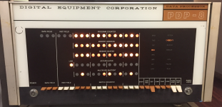

We are making progress on the recently donated DEC Classic PDP-8. All of the front panel switch paddle pivots have been repaired, thanks to Doug for the drill fixture. Fortunately all of the front panel lights are working, so I don't need to do more fiddly work there. The resistance of the bulbs varies, so I imagine that some incorrect bulbs were substituted. The next step is debug and repair. The STOP switch doesn't stop the processor. That might be an easy problem to fix first.

We found a shorted D-662 diode D1 on the S107 FlipChip in slot PD31 that was causing problems with the STOP and SINGLE STEP functions.
Memory EXAM works, but DEP does not. I work on that next.

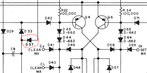

We noticed that the MEMORY ADDRESS bit-3 is always on. We swapped the R211 FlipChips in slots PC10 & PC11 for bits 3 & 4. Now bit-4 is always on, so the problem is on the R211 FlipChip now in slot PC11. We put the R211 FlipChip from slot PC10 back in slot PC11 from where it came. We don't have a parts layout for the R211, so we tested all of the diodes that are part of the MA circuitry. One D-664 diode measured 0.103mV drop in one direction and 0.209mV in the other. It should measure 0.7mV and 0.0mV. We replaced it with a new D-664 (1N3606) and now all of the bits in the MA work OK.

You probably have the R211 schematic but here it is anyhow. I don't have a physical layout drawing.
Our boards are the "J" revision. It would be a lot of work to determine the reference designators of each component and where the are on the board. It would be handy to have though.
Eagle, by default places the names off-center; diodes and resistors are labeled below, capacitors above, transistors off to the side near the collector pin.. Does that help interpret the file I sent?
(Components rotated 180 have the label on the other side, just to make interpretation harder.)
Supposedly this helps with the aesthetics of the silkscreen layer (but really it just seems to make arrays of diodes and resistors look "off by one". It also doesn't help that the part outline for the diode has a diode symbol where you'd want the text.
It should be possible to write an ULP to place the device name at the center of the device but on another layer. Then you could select the new layer to get a better placement diagram.
I will look. Thanks for your help.
It was D37 on the R211 in slot PC10 that failed. Being connected to the base of Q4 would explain why this flipflop could not be changed.
