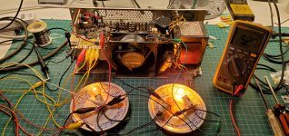

What is the chassis pulling on the +5v line
Feels like its overcurrent.
D2 1N3899... to clarify, do you mean CR2 on the schematic? If so, my diode checker function reads no reverse voltage pass through, and 0.34V forward voltage on both CR2 and CR1 (the latter is the equivalent for the 15V regulator).Looking at the schematic, the 723 (I prefer LM723C because it's a later revision) is in a switching PSU configuration. Have you replaced D2 (1N3899R)? That functions as a snubber and can lead to all sorts of woe if it's failing. Note the "R" on the part--it's a stud-mounted diode, but in reverse polarity from a standard 1N3899.
Just a guess...
The first problem I solved after reforming/replacing the 5 big capacitors was figuring out why the main fuse would blow instantly on power-up. The big bridge rectifier was the reason -- one of the internal diodes had shorted closed.R27 shouldn't be getting anywhere near that hot, it should only be disappating about 1/2 of its rated power. I would have guessed a bad diode in the bridge rectifier but you've already replaced that.

Confirmed, it is the 1N3899R variant of the diode.Yes, CR2--and you've verified that it's the "R" variant on the board (could be that someone tried a standard '3899 there. That would not be good.)

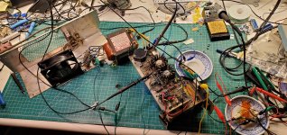

I was not aware that current probes existed. The difficult part is finding a good place to measure, as the 5V and 15V rails on the power supply PCB are double sided -- top and bottom. Can you get an accurate measurement while only sampling one side?Have you considered possibly using a Hall-effect current probe such as this https://www.crowdsupply.com/weston-braun/little-bee to measure current without ripping up traces?

I don't like these type of shotgun style parts replacements. They are a lot of work and expense and rarely solve anything. It may be better to carefully analyze the circuit and understand how it works. An LM723 based regulator is not too complicated although in this example DG engineers did a few odd things which I don't fully understand. With the limited understanding I would suggest the following simple tests with a load which takes about 1A (suitable light bulb or resistor):I have replaced a significant portion of the components already. Here's a recap of everything I've done on this power supply so far:
I'm assuming you are saying that the 5 and 15 traces don't overlap each other on the opposite sides of the board, but that each one is duplicated on the opposite sides of the board, for some distance, and they share the total load for that rail. Obviously if you only have one trace it carries the entire current and you could calibrate for an absolute reading with the probe. More often you would probably not calibrate for absolute and just use it to find relative ratios between probed different locations to find where the heavy load was.I was not aware that current probes existed. The difficult part is finding a good place to measure, as the 5V and 15V rails on the power supply PCB are double sided -- top and bottom. Can you get an accurate measurement while only sampling one side?

Yes, they do overlap on the board. On the connector to the resistor board, they're sandwiched top and bottom.I'm assuming you are saying that the 5 and 15 traces don't overlap each other on the opposite sides of the board, but that each one is duplicated on the opposite sides of the board, for some distance, and they share the total load for that rail. Obviously if you only have one trace it carries the entire current and you could calibrate for an absolute reading with the probe. More often you would probably not calibrate for absolute and just use it to find relative ratios between probed different locations to find where the heavy load was.
Another alternative would be to use a thermal camera and see what is getting hot.
I mentioned it before, but I'm not a fan of shotgun replacements either. Everything I replaced before I did so with a reason. It was either known failed, or suspected of drifting out of spec, and hard to test in-situ under load, so it was safer to swap.I don't like these type of shotgun style parts replacements. They are a lot of work and expense and rarely solve anything. It may be better to carefully analyze the circuit and understand how it works. An LM723 based regulator is not too complicated although in this example DG engineers did a few odd things which I don't fully understand. With the limited understanding I would suggest the following simple tests with a load which takes about 1A (suitable light bulb or resistor):
