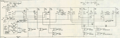

Tests of the front panel showed it would work sometimes, and fail other times. Digging into the logic, the /CONRQ line was not triggering sometimes, as the voltage threshold on the analog OR gate was insufficient. It took some time to determine that the 5V rail drooping too low for the logic to work right. I cleaned the card-edge connectors on the PSU and resistor board again to ensure there wasn't any voltage drop from dirty contacts. Then I boosted the voltage on the Meanwell PSU, but this comes with a consequence: if 5V goes up, so do the 12V and -5V rails. I was able to find a suitable adjustment where 5V was nominal at the front panel and on the CPU logic board's far edges, but the 12V rail climbed to 13.5V -- yikes! Now, no regular Nova PSU has 12V, but mine does as it's being used to feed the VLAMP bus and the chassis fans. The VLAMP rail on a Nova can be anywhere between 11V and 17V depending on the system (though 13-15V is pretty common). The bulbs will tolerate plenty of voltages, and I prefer to under-volt mine for the sake of longevity. However, the 12V fans won't like 13.5V, and will likely cook themselves to death before too long. I added in a pair of large diodes to drop the voltage to just under 12V for just the fans. That fixed the front panel logic's inconsistencies.
The next problems were found in basic serial tests, printing all ASCII characters or echoing characters from the terminal. I found failed chips on both the Cassette I/O board and the CPU board, specifically ones that handled the /DS5 signal having incorrect levels when signalling between the boards. With that, simple serial tests seem to work fine again.
Then the big problem, which took alot of work to diagnose and fix...
I tried running the 095-000036-01__Nova_1200_Logic_Test__1970-1974.ab diagnostic tape, and was getting very confusing responses from it. I figured it was supposed to tell me over serial what was wrong, but it wasn't giving me anything. It was getting stuck in one of a few places, mostly related to it trying and failing to report errors via serial. The trick was to single-step through the program until we hit a test that didn't pass: the auto-incrementing addresses.
On a Nova, addresses 00020 thru 00027 auto-increment values when accessed. Meanwhile, addresses 00030 thru 00037 auto-decrement values when accessed. These functions worked, but unfortunately they were being activated on addresses 00120 thru 00137 which is not right at all. It took days of tests, writing custom tests derived from the Logic Test diagnostics mentioned above, and lots of oscilloscope captures before it was finally found. Within the circuitry that handles the auto-inc/dec flag, the N8859A quad-input NAND gate that is part of the address decode logic was ignoring the /MBO13 and /MBO14 signals. That part has been replaced with a 74LS20 (despite technically requiring a 7440, Fairchild 9009, or the aforementioned Signetics part, which has no datasheet) -- it's fine, the LS part has enough fanout for the other circuit it's wired into. So, that problem finally got solved, but it was a pain to nail down why it was happening because it's only using a single 4-input NAND gate to decode a 16-bit value for a 15-bit address. DG pulled this off by cycling through one nibble of the instruction at a time, synced with the four Processor Time Groups (PTGs).
Anyway, that took alot to figure out, and it still doesn't work completely yet, but that's like 3 to 5 problems fixed in the span of a week, so I'd say that's pretty good progress. I'd call that a fruitful week!

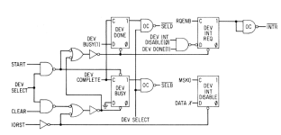

The bad news: when the Cassette I/O board is installed, it fails on test C53:
Right now I'm running down the logic that drives /INTR line for the serial interface on the Cassette I/O board to signal to the CPU. Seems like it's stuck triggering all the time and should not be, which is no bueno.
But hey, progress.

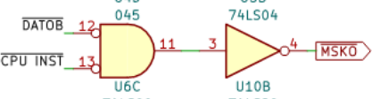

The fault was initially traced back to the interrupt generator circuitry on the Cassette I/O board, but my hypothesis is that it's not being set or disabled properly by the CPU. I/O devices' ability to trigger an interrupt is generated by a circuit matching the following from the "How To Use The Nova Computers" manual.
I don't even think that interrupt disable signal is ever reaching the Cassette I/O board, and sure enough, pin 11 was not changing to follow 12 and 13. Thus the /MSKO signal wasn't being generated properly on the CPU board. The chip in question is not a flavor of 7402. but rather a Signetics N8885A which is not pin compatible. The first input pin and the output pin are switched for each gate, and I don't keep many spare Signetics parts on hand.
So a temporary replacement for the N8885A was fashioned with a chip carrier, a 74LS02, and some wires (which sadly hasn't fixed the issue).
For some reason ever since this temporary chip replacement tower was constructed, the /DATOB signal isn't being generated, so I can't even see it the effects of /MSKO possibly being fixed.

Testing continued, ended up chasing down the rabbit of where that interrupt was coming from on the Cassette I/O board. /INTR jumped around a few times, though I'm convinced that might have been from me getting mixed up on gates as I was working. The Clock Interrupt was the one in particular that wouldn't go away. Note the cyan and magenta signals coming out of U117 CLK DONE. They should be mirrored perfectly and they aren't. I also noted that pin 3 never changed, and yet, even with that /CLK BUSY signal at a 1 all the time, CLK DONE was always set. You would think that the /RESET pulse (yellow trace, pin 4) would clear it and keep it cleared, but it kept setting again at the conclusion of that pulse.
So, a bit of desoldering later, and U117 is out, and replaced with a new LS series part. Since there is no pull-up or driving logic on pin 1 (one of the /PRESET lines), I added in a pull-up resistor. Original 7474's don't need those, hence why DG doesn't have one.
Sure enough, the original is dead, and fails testing, where other non-LS 7474's pass.

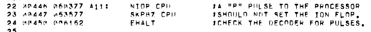

The Nova 1200 made it less than week before it broke again. 😣
The good news is that serial echo routines and ASCII loop routines work okay. However, something failed so badly that I can't even get the bootstrap program to correctly pull in a the binary loader to bring in the full Nova 1200 Logic Test diagnostic tape. Great.
My approach for the moment (beyond checking the basics) has been to hand-toggle the instructions for the aforementioned diagnostic routine by hand. Ideal? Not in the slightest, but so far it's shown me some avenues to explore. The first was test A20:
The second is test A11:
ION circuitry seemed okay at first glance, I'm not seeing that flipflop set, which is good. Right now the initial suspect is U11, so that's going to be replaced soon since it doesn't appear to be flopping right.
